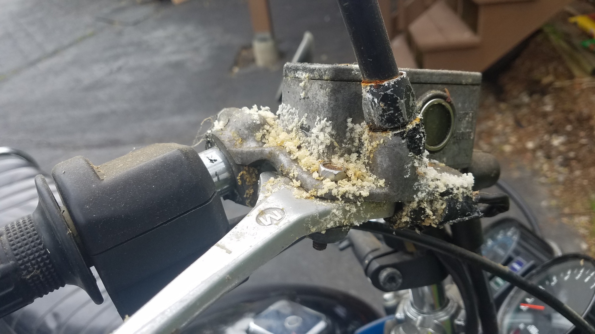

I think I've decided on superbike bars... only issue I see would be the master cylendar but that has an issue right now so may need a replacement anyways.

From the pics your motorcycle is a 1982 KZ650-H2 CSR. My 81 model is virtually the same except for the carburetors.
I installed Emgo Euro bars from Z1Enterprises, but plan on going with superbike bars if I ever get around to swapping
the master cylinder >> I got one from a 2014 Honda CBR500R & the Fr brake light wire lead from a KZ1000P Police.
I also installed a shorter clutch cable & shorter upper brake line, but haven't done the throttle cables yet.
Before changing bars, I moved the turn signals to the headlight bucket. you may have to do the same w superbike bars.

thank you! Found the OEM part number
Honda MASTER CYLINDER SUB-ASSY., FR. BRAKE (COO) (NISSIN) Part # 45510-MGZ-315

The used mc in the pic is in very good condition >> I got it for about $30 on EB.
Partzilla has them new for $70 which isn't bad for a new oem mc.
From your pic you'll probably need to redo the entire front brake >> new brake lines, caliper rebuild, maybe a new caliper piston.
I installed Goodridge lines & fittings and K&L caliper rebuild parts from Z1Enterprises.

Yeah I suspect I would have to rebuild it all since it's been sitting for so long.
