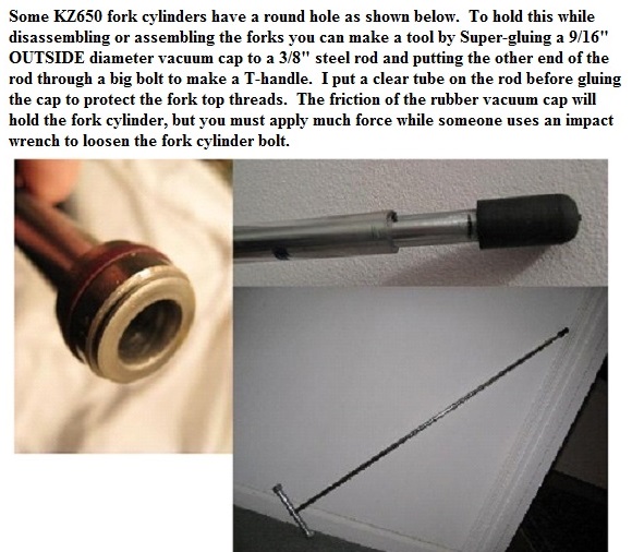

#802862
If the top of the fork cylinder on your bike is like the one on my 1977 KZ650-C1 it will just have a round hole rather than shape that a hex bolt can engage (see image below). If that is the case you can either make a tool to hold it as shown in the image below or you can buy one like the one shown in the middle of the top row at www.racetech.com/page/id/70 . Ed
