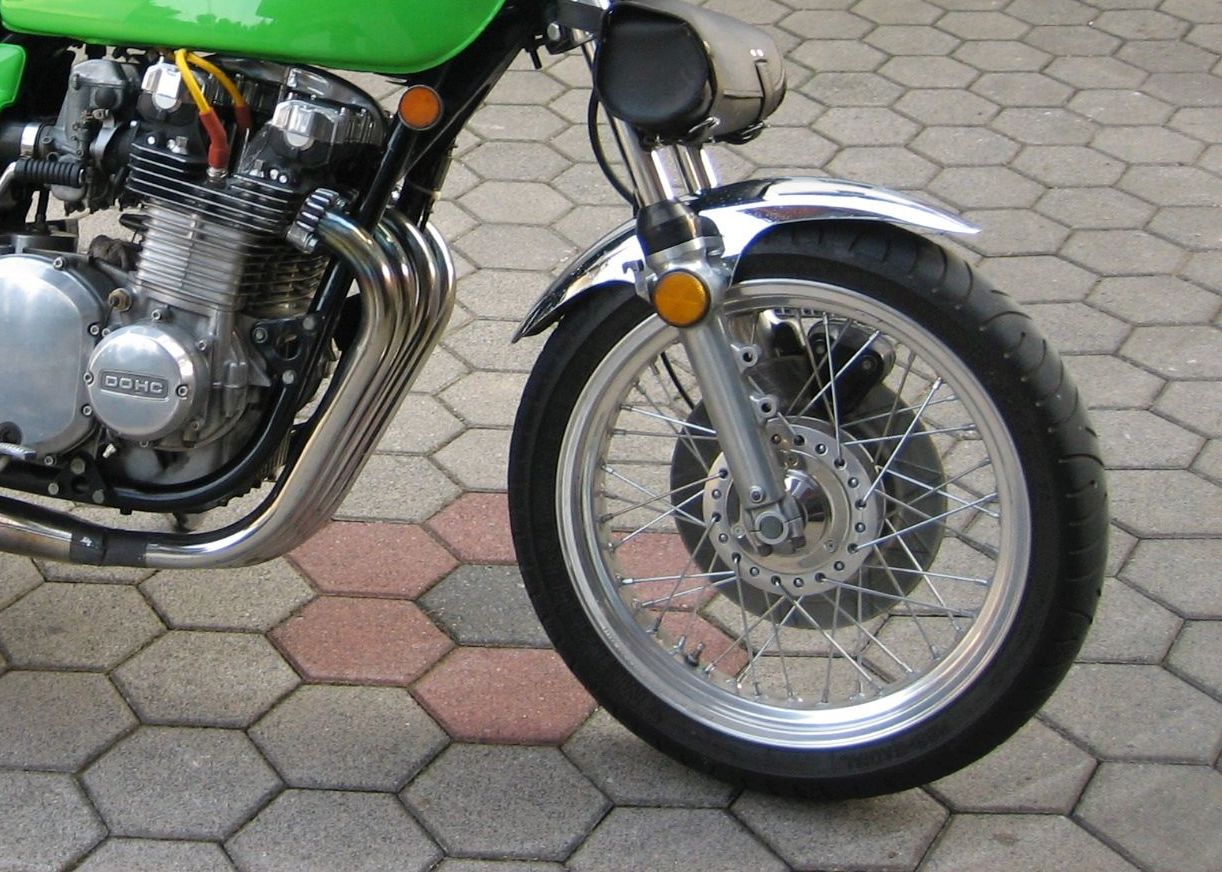

The maximum wheel and tire size for the stock fork i had used in the late 90th was a 3.50 x 18 Akront wheel and a 120/90-18 tire.
The front fender mounting points on the fork tubes need some little processing.
