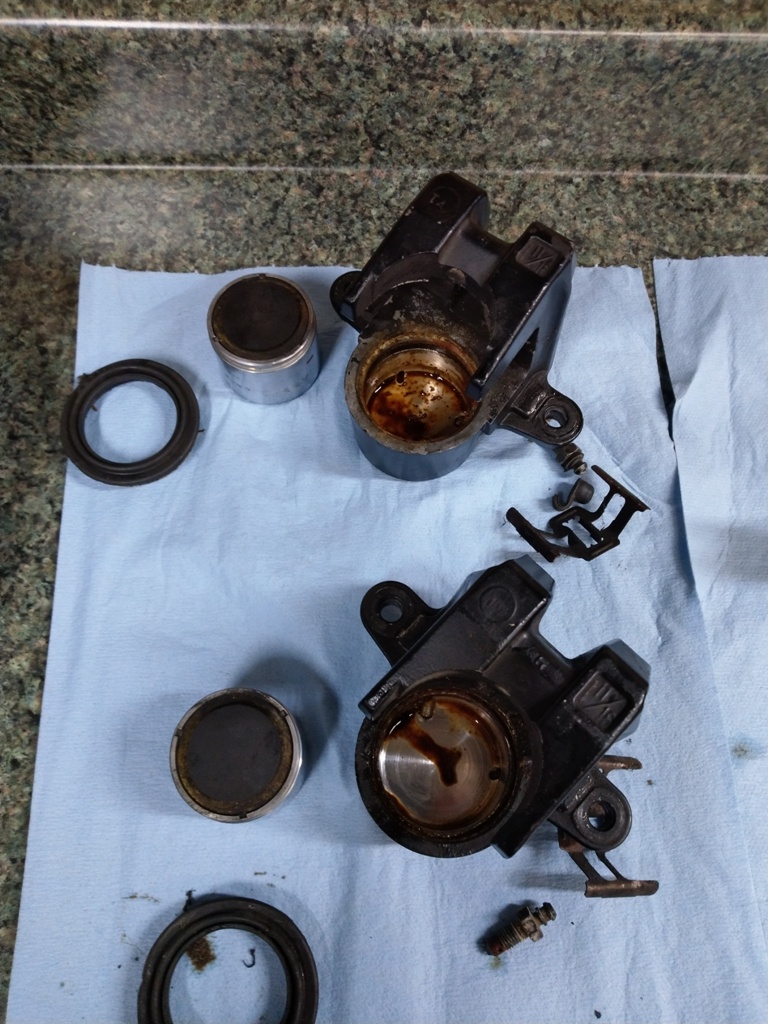

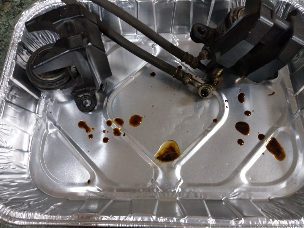

You are on the right track. That master will work and replacing the lines is critical since the old ones are sure to be full of crud and the rubber deteriorated. I'd add a teardown of the calipers to the list of things to do since they are likely full of crud too. Changing the seals is a good idea and if the piston is pitted that should be changed too. OEM seals are the way to go. K&L brand brake system parts suck. I've had nothing but bad experiences with them.

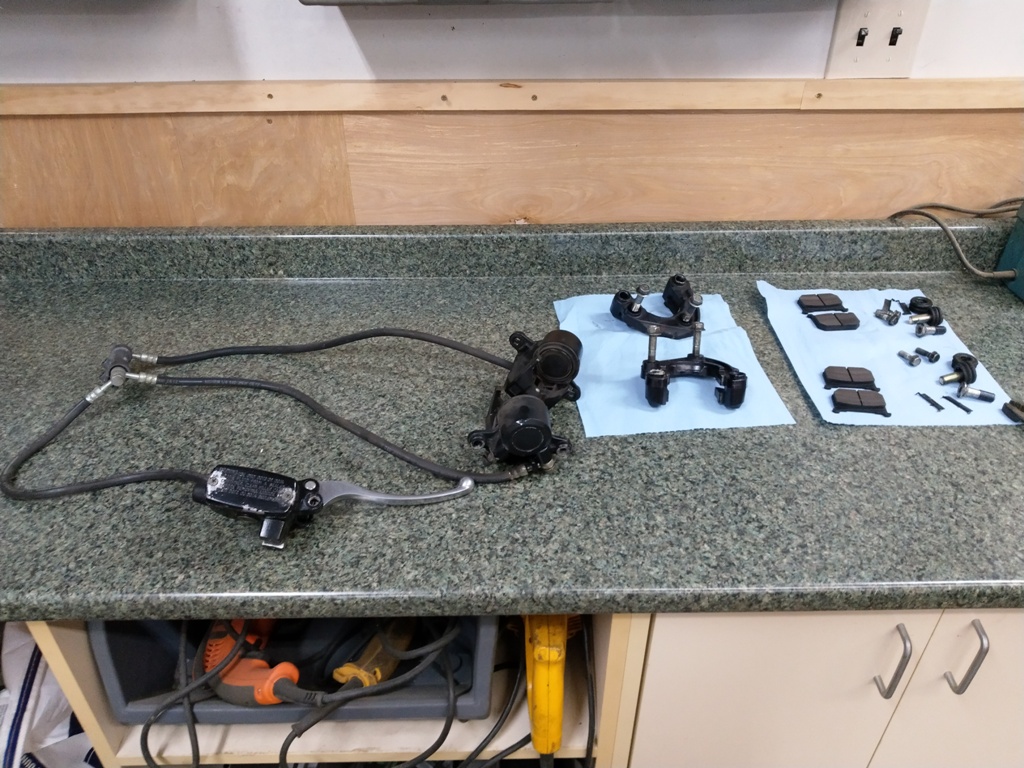

No eBay APP ID and/or Cert ID defined in Kunena configurationOk, ordered up some caliper kits too. Hopefully the pistons are ok. I will likely strip everything tonight. Won't have parts until Friday.

That looks like a aftermarket MC anyway.
