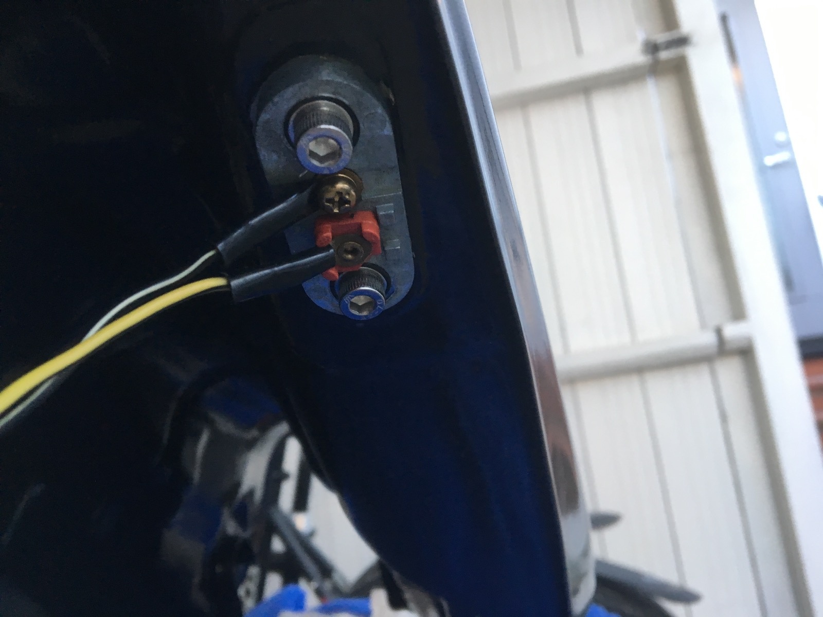

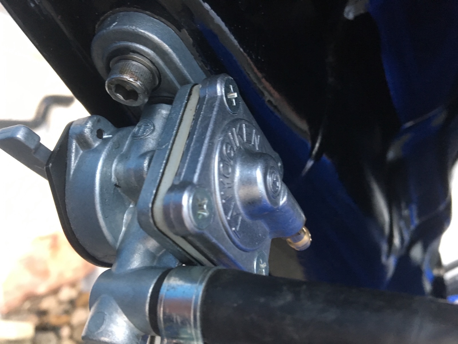

Hello everbody, how do you get the level indicator and the fuel valve gas tight when it comes to the screws?
Do you use rubber o-ring around the screw and a washer?

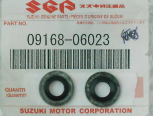

These Suzuki parts are what I use, PN 09168-06023. They are a steel washer with a rubber lip on the inside. Sometimes denoted a "dowty seal".

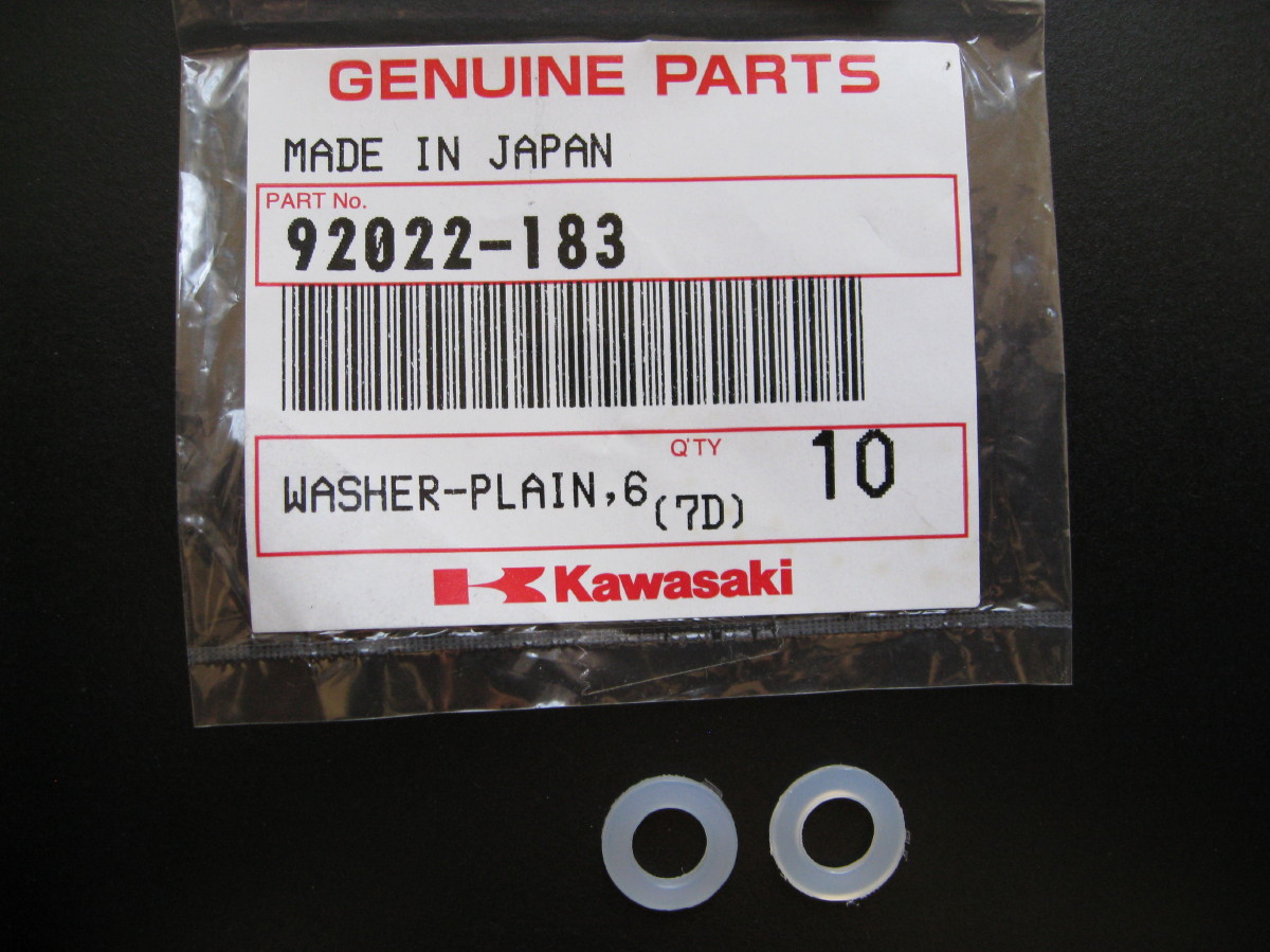

Kawasaki used a white plastic washer & they should be available at the dealer. I'd guess they're nylon plastic, so maybe the hardware store has something. But the above suggestions would work as well or fiber washers.
WASHER,5.2X10X1.5
Partzilla >> 92022-1023
WASHER,5.2X10X1.5

14 Apr 2019 06:10martin_csr wrote: Kawasaki used a white plastic washer & they should be available at the dealer. I'd guess they're nylon plastic, so maybe the hardware store has something. But the above suggestions would work as well or fiber washers.
WASHER,5.2X10X1.5
Exactly. Here's what they look like. Ed

Thank you all, as always spot on and good feedback/help!
I have purchase 4qty of 09168-06023 now.

09168-06023 worked perfect for the petstock, but was to large for the gas level switch indicate.. so you was correct martin and 650ed, will get two of 92022-183.

24 Apr 2019 19:34gordone wrote: 09168-06023 worked perfect for the petstock, but was to large for the gas level switch indicate.. so you was correct martin and 650ed, will get two of 92022-183.
Thank you all.
Can you shave down one edge of the washer?
