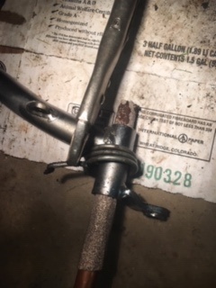

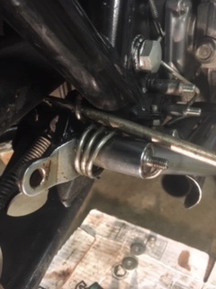

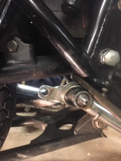

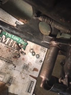

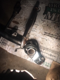

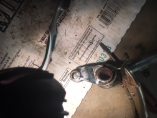

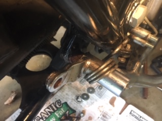

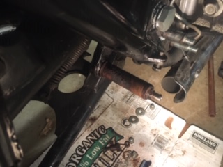

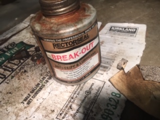

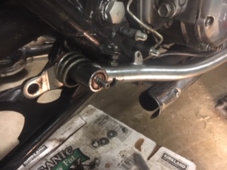

Photos of my rainy after noon project. Rear brake lever would not return and stop light was on so took the right foot peg off and nut holding the brake lever on its axle. Here is a long screw driver trying to pull back the return spring from the frame bracket.
Pulling the brake pedal off its axle, without the spring getting around the frame
Got it off look at the rust on the pivot rod and inside the pedal
sandpaper wrapped around a 1/2" piece of copper tubing cleans the inside of the brake pedal and wire wheel tackles the pivot rod itself
clean now
back together and I used this copper based never-seize.. Spring right back now.
. thanks for the help.
