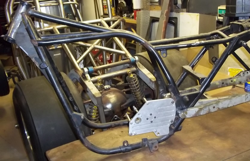

You can contact PDM Fabrication
There ad is at bottom of each page here at KZRider
The owner is Les Holt. A respected member here.
He can create a swingarm for you that will fit and take a large tire and
be any length you want .
He makes all my custom parts on my turbo bike

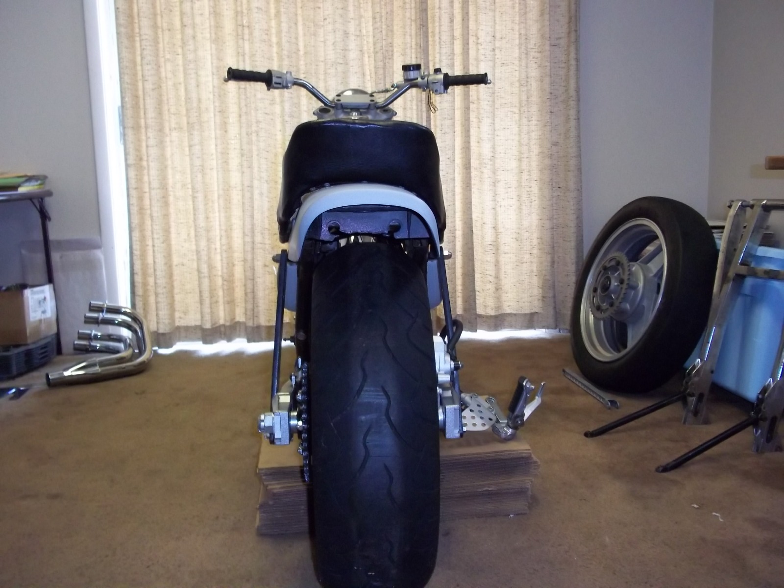

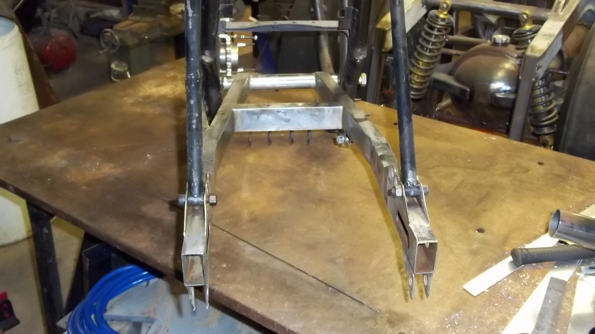

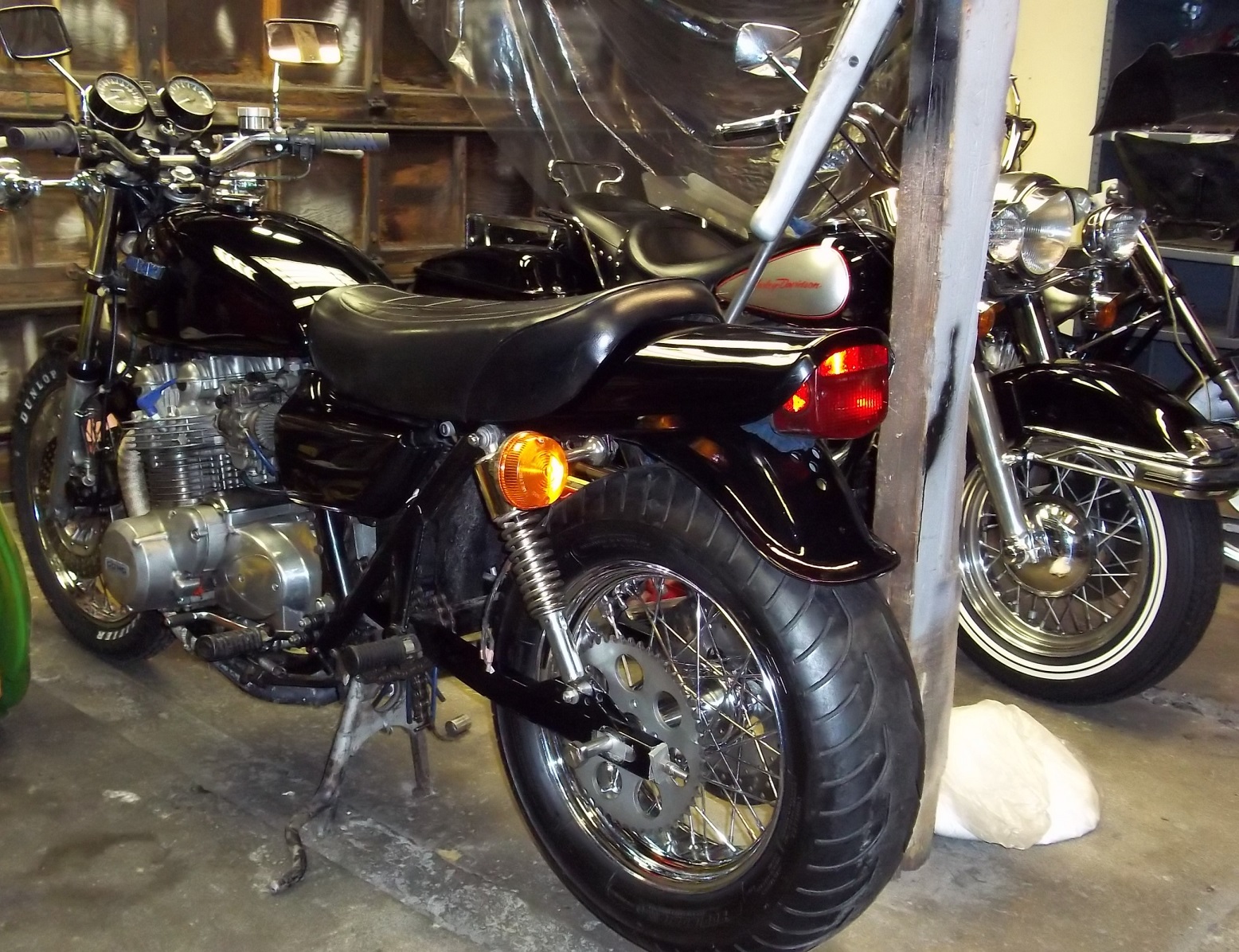

What's you use plan? Drag? Cruise? High Speed? Or just to be COOL at cruise night?
Budget dictates it all of course!
Don't go too long!
Try the old Suzuki GS conversion. 160-180 tire is pushing it.
For wide. And cheap, the Kaw ZZX 600? 2004-7. Thee parts are cheap on ebay. Really easy to convert, for 2 shocks like stock
Or have custom built to your specs by "PDM"
Your opening up the worm can / rabbit hole! offsets, frame mods, etc..
Keep an offset of 5/8" at engine.
Good Luck.

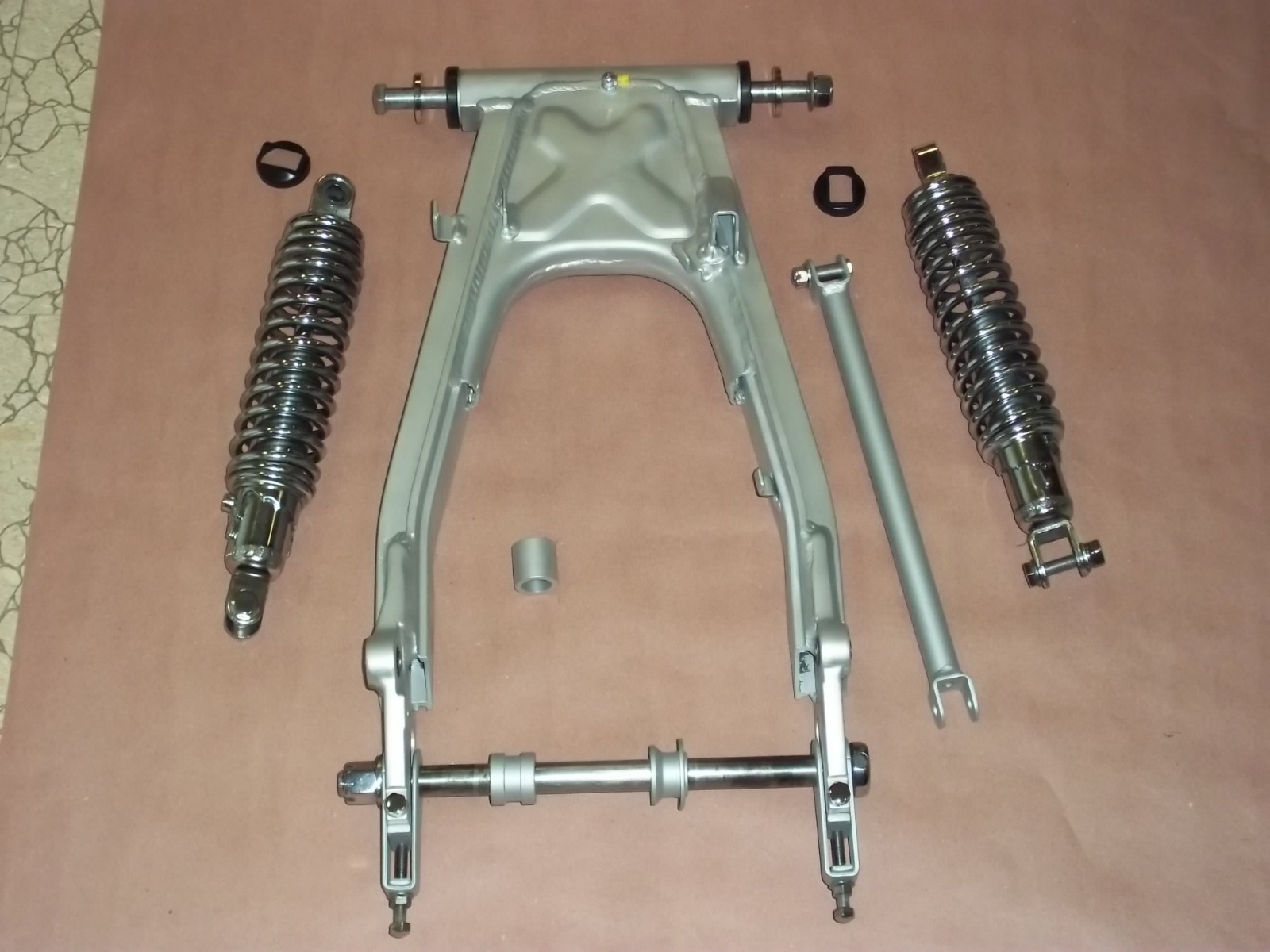

Going with a 200 and larger tires really create a headache. I've done 190's without clearing the frame for chain clearance but it's a tight fit! With that said, i's suggest going to an outboard bearing sprocket setup and just go for broke. I can do a whole setup ready to ship that just bolts right in, all you'd need to do is set the back wheel spacing.
