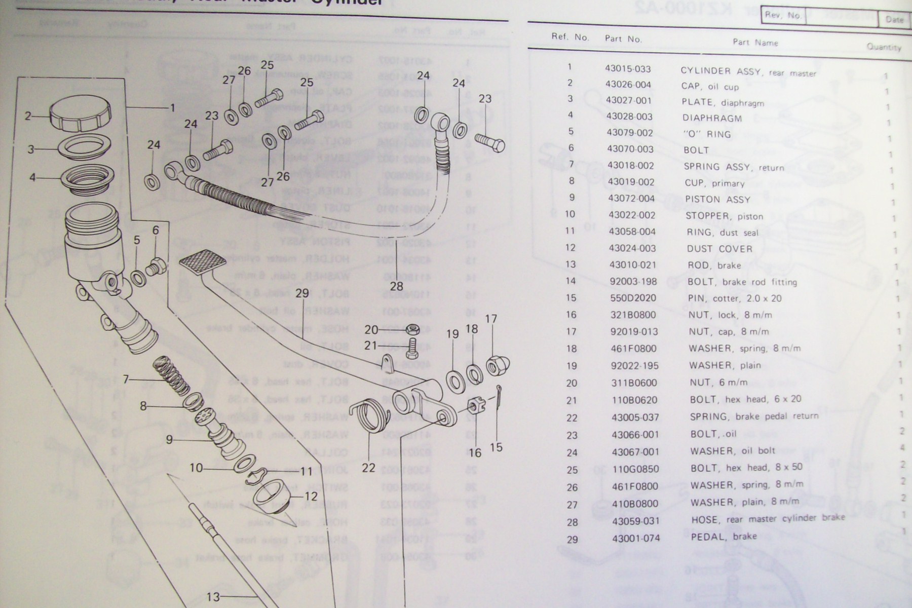

OK folks, you made me dig out my OFFICIAL KAWASAKI PARTS BOOK for the 1977 KZ1000A1.
Not a 1978 KZ1000A2, but a 1977 KZ1000A1 ONLY!!!
Please notice #25 on the parts list is a 110G0850 bolt. 110G makes it a common 8X50mm BOLT!!!!
That bolt is NLA from Kawasaki anymore. You could use a 130G0850 flange bolt instead.
There are all kinds of major errors of parts listings on many of the 1970's and 1980's models every since Kawasaki got away from microfishe and went to those newfangled computer parts diagrams!!!! DON'T LIKE THEM, AND I DON'T TRUST THEM AT ALL!!!!!
After 33 years of working parts in Kawasaki dealerships, I am VERY GLAD I am now retired and I don't have to rely on them God Da@@ computers to look up parts!!!!!!!!!!!!!

Perfect! That's just what I was after. Thank-You for taking the time to dig-up the "Good" stuff. I look for the ole fishe on ebay, sometimes they are for sale. Yes a flanged Bolt would work just fine but I just want period correct. Got a couple refurbed masters i'm finishing-up. Sorry for the delayed Thank-You, I don't get on the computer that much.
