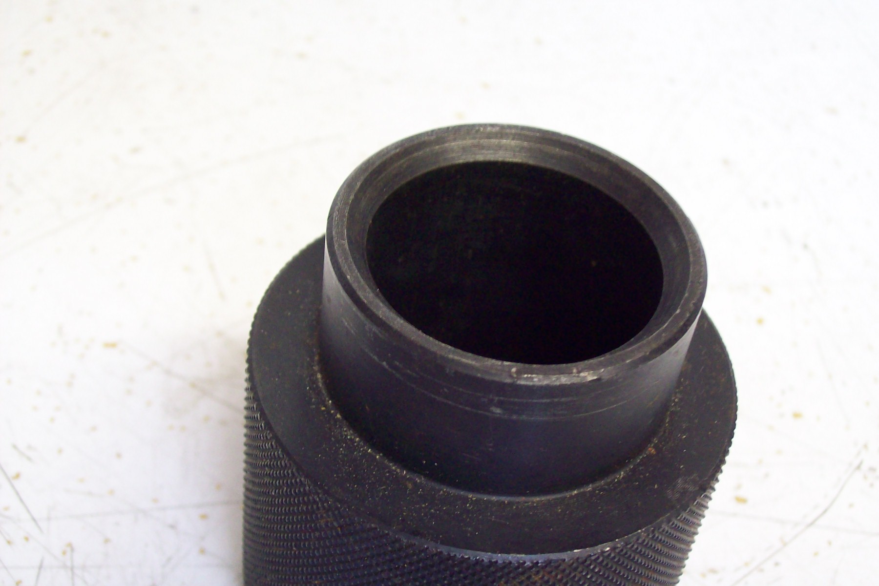

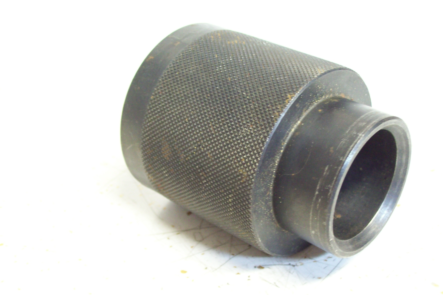

Without looking it up in a Factory Shop Manual, I believe you need the tool like the one pictured below to install fork seals in the GPz front forks. This tool fits over the inner fork tube and slides down on top of the fork seal. Then you tap the fork seal down into place in the lower fork tube with this tool..
I myself have never installed fork seals in the GPz style forks without using a tool like this. You might get by trying to use a piece of pipe that fits over in the inner fork tube, but not bigger in diameter than the O.D. of the fork seal.

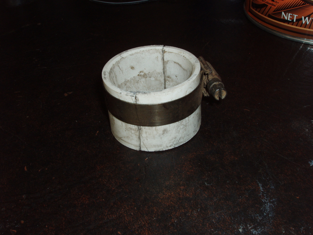

here's a pic of a couple forking attempts.
this is a project that was going to take an afternoon and is going on it's second week. i should have known it was going to fight me when one of the bottom bolts wouldn't come out with my 3/8 impact, so i got the 1/2 incher and it promptly rounded out the 8mm allen :evil: .
one step forward and two steps back.... but hey, it runs great!

dr gamma, my tool is the homemade version of that (pvc pipe cut in half, fitted and clamped together) and i've never, up to this point, had a problem.

Same idea!! Should work just like the factory tool then!!!

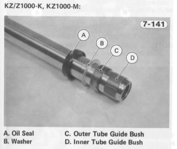

Here is a snip from my Kz1000 manual for tube components assembly.

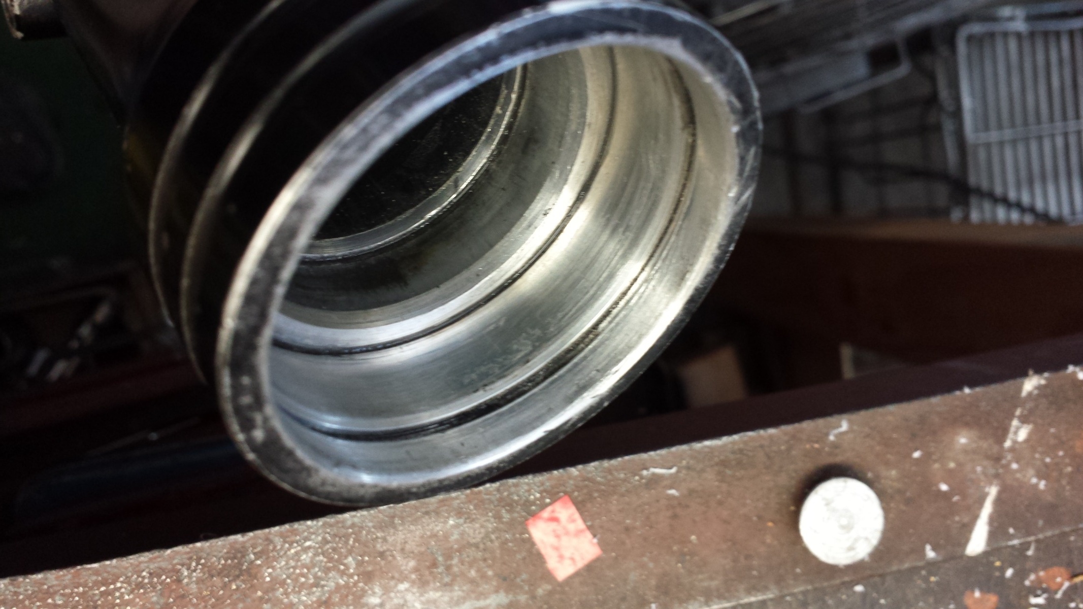

it takes a lot more care in getting them started straight than i'm used to, but even if you do, whenever the seal starts to disappear, the outer part delaminates as shown in the bottom seal in the pic. the one on top shows the side just starting to bubble.
inside of the slider seems as smooth as it should be.
