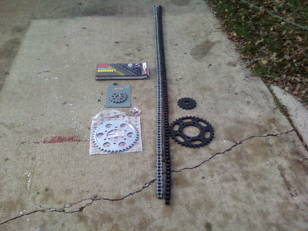

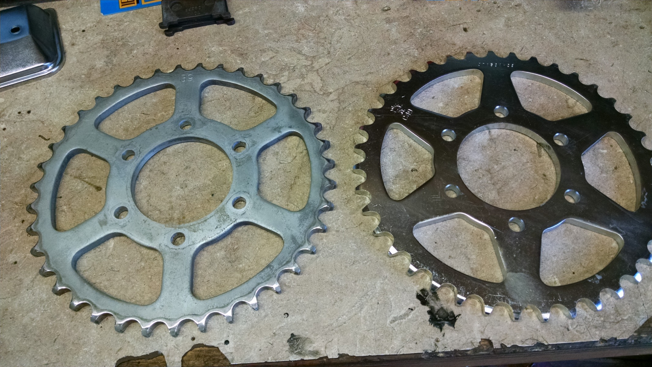

I put on as close to original as I could find to the original endless EK 630 chain. (no master link) I bought the EK riveted chain off of eBay, and a cheapeo riveting tool. I bought stock ratio 15/39 aftermarket sprockets from Z1, but in hindsight wish I had looked harder for OEM sprockets. They do seem to be holding up ok. No issues so far anyway.
From my research Jeff at Z1 is the holy grail of the 530 conversions. I did not want to go with a lighter chain on this monster. :woohoo:

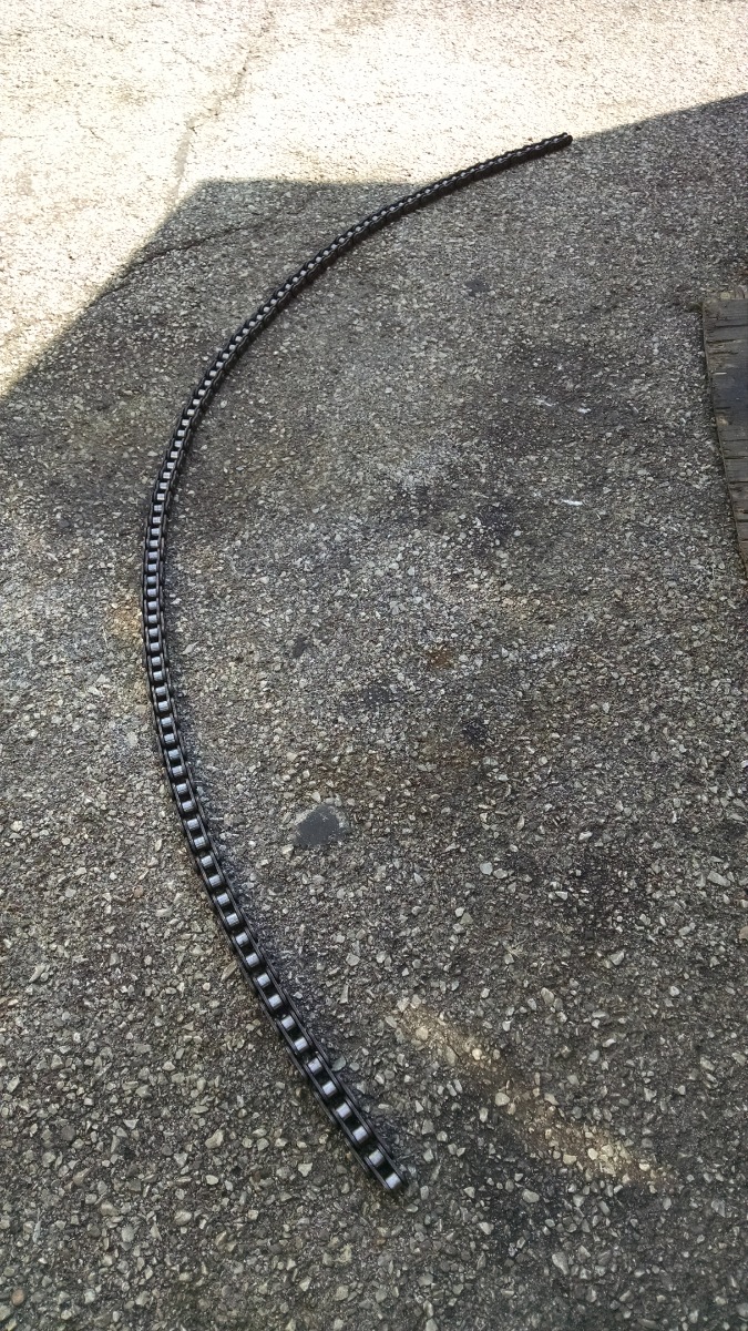

This chain is freakin SHOT. It was binding up so bad that I was worried about the output shaft bearing.
The aftermarket rear is a little heavier than the OEM sprocket. 39 tooth.

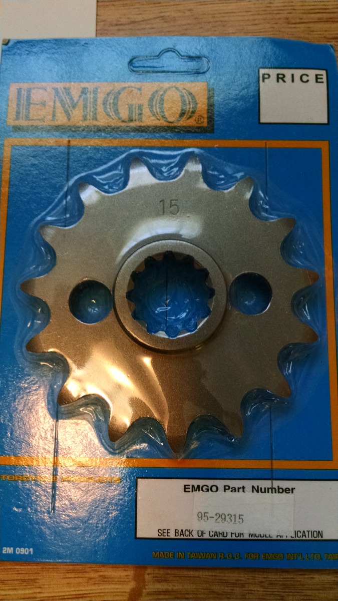

The emgo aftermarlet was close, but no cigar. The lock holes were too small, so I had to grind down the lock clip tabs to fit the close, but no cigar cheapie sprocket.

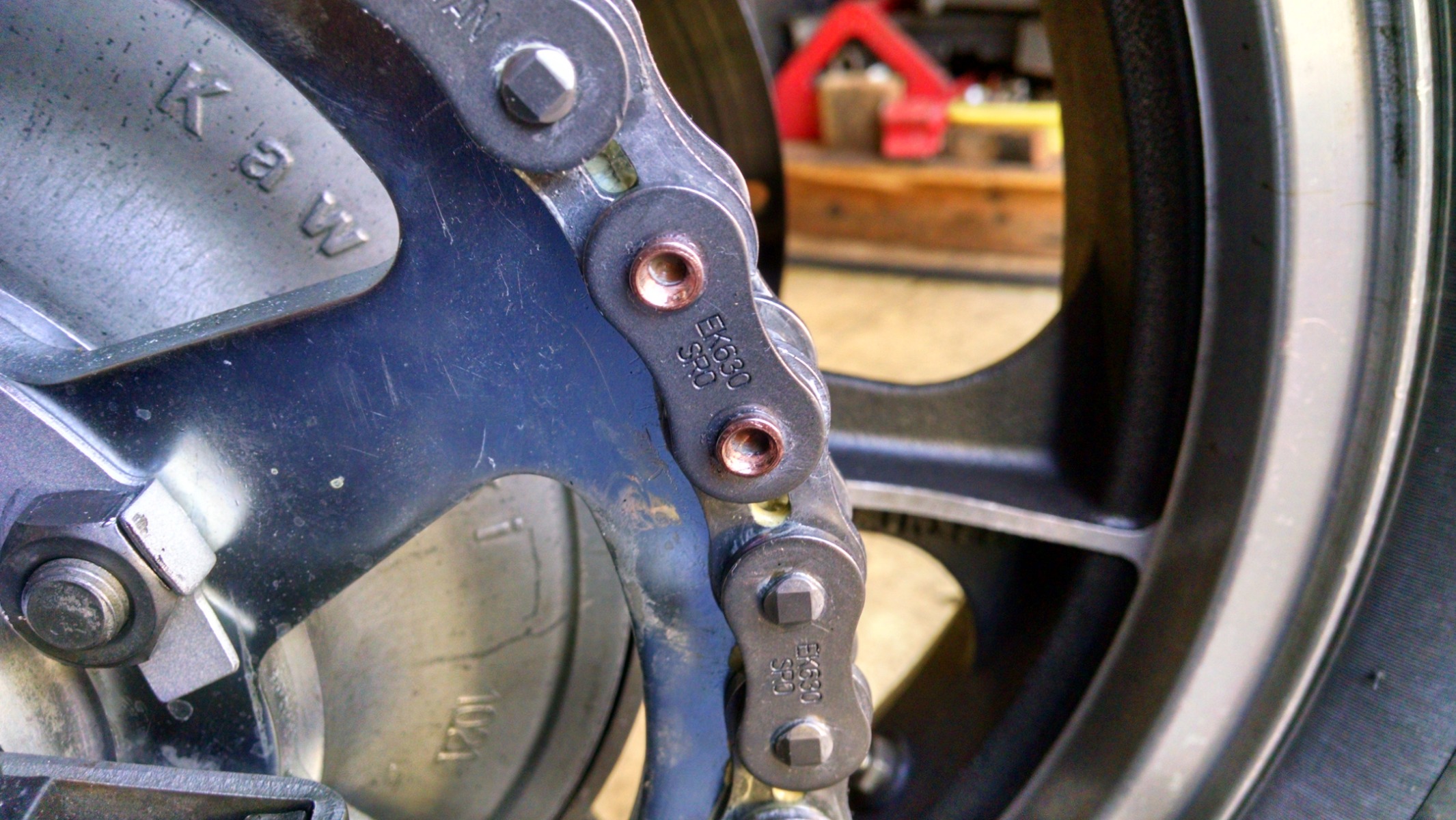

The orignal was a EK 630 o-ring chain, so EK 630 o-ring chain went back on.
I screwed up the first try and made sure to buy the exact match master link for this chain. I am not comfortable using a combine master link on a ~100 HP motorcycle.

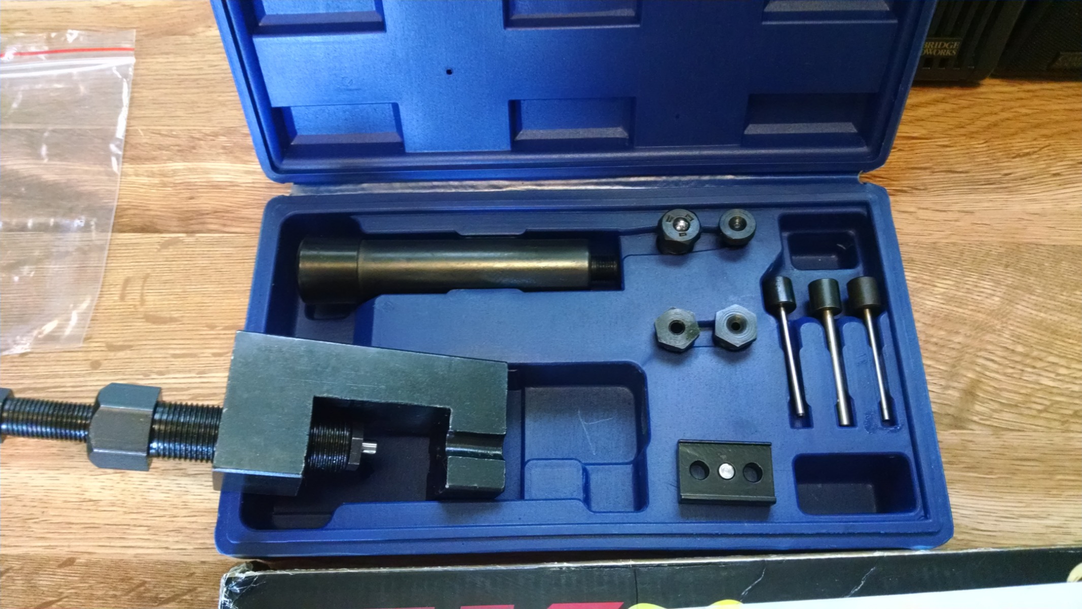

Cheapo riveting tool:
