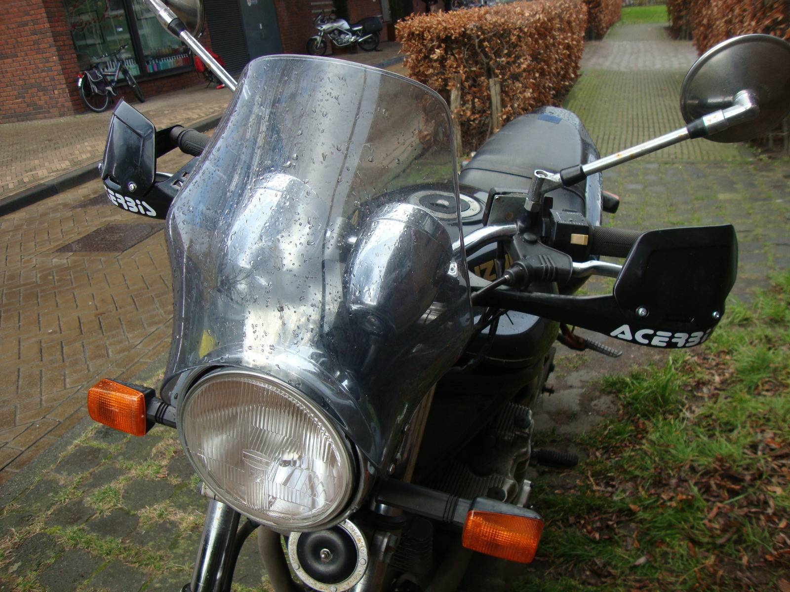

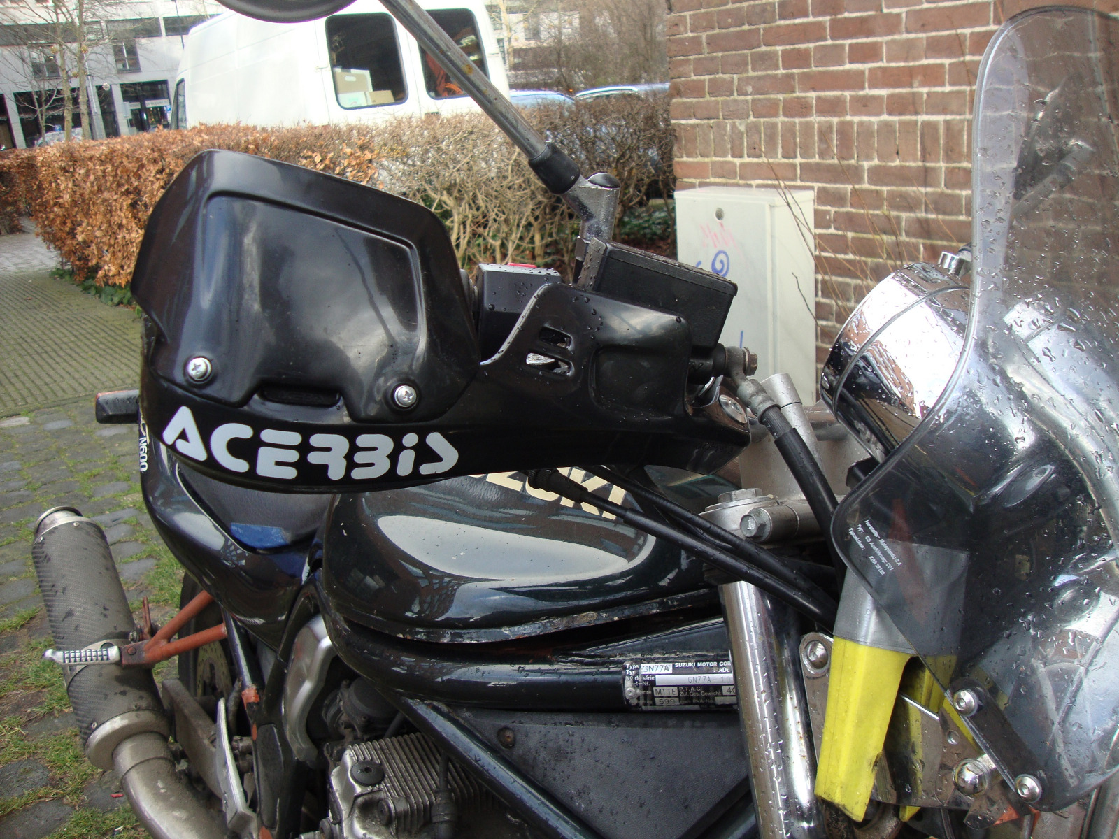

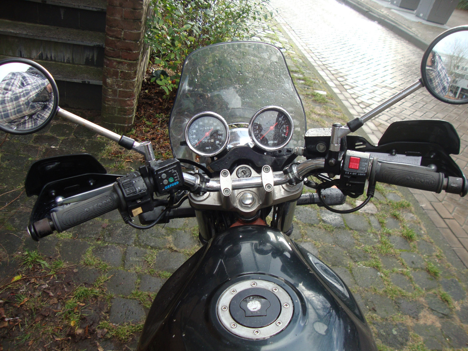

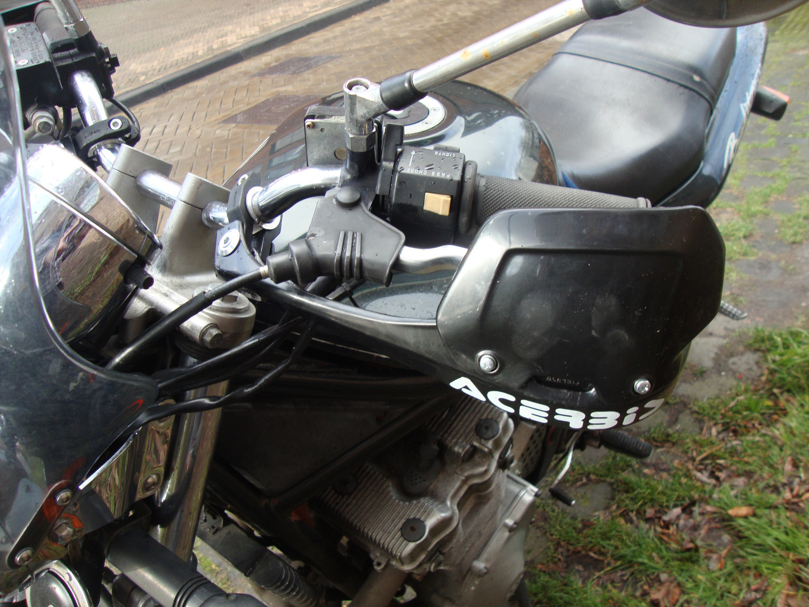

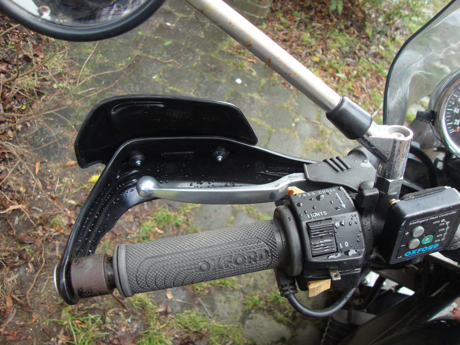

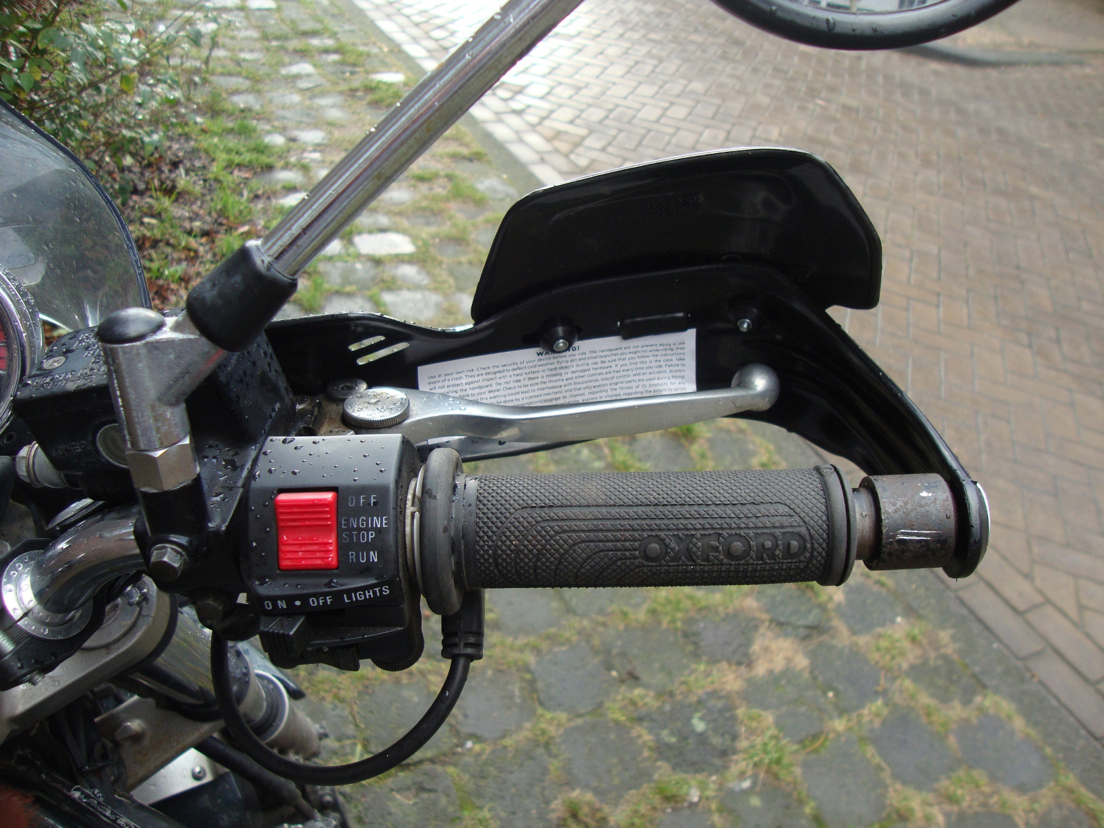

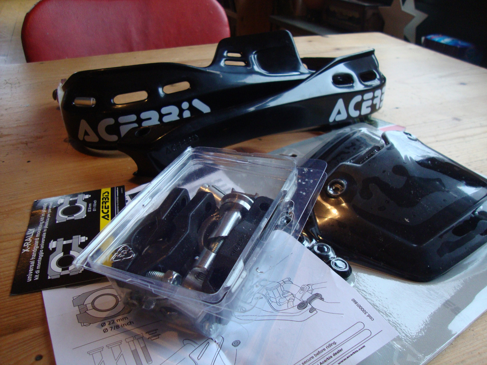

I understand there is a whole science to tank slappers. Many things can contribute. Hopefully not something Ill have to worry about as I ride like an old lady. The reason for my post is that I wanted to fit a pair of handguards to my daily ride (Bandit 600) as the snow has arrived here in Holland and the hot grips only work on the inside of my hands.I wanted something to cut down on the wind blast. I bought a set of Acerbis guards but to get them to fit,I needed to extend the bars. Hence the question about bar end weights.
I had a set of bar ends from an old Honda which I have fitted and managed to get the Acerbiseses mounted. Not perfect but boy do they make a difference. I would highly recommend them to anybody that rides through the winter.

Id like to see more on how you fitted the bar ends.

Here you go Steve. The mounting instructions that came with them are straight forward. I did have to turn the brake line out of the way a bit but for the rest it went pretty good. The guards themselves are quite flexible so you can twist them about to fit.[/attachment]
they cost about euro90 including delivery from Germany.
