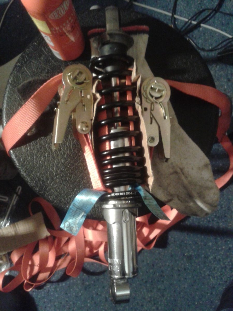

24 Jan 2019 12:33loudhvx wrote:
It would be a good idea to make/get a tool to remove the springs
The tool i use to remove the springs and keepers.

Is that a genuine Kawasaki tool? Theyre quite expensive!!
I see Koni printed on the spring. If they are Koni shocks you might be in with a chance of getting replacement parts from Ikon.
