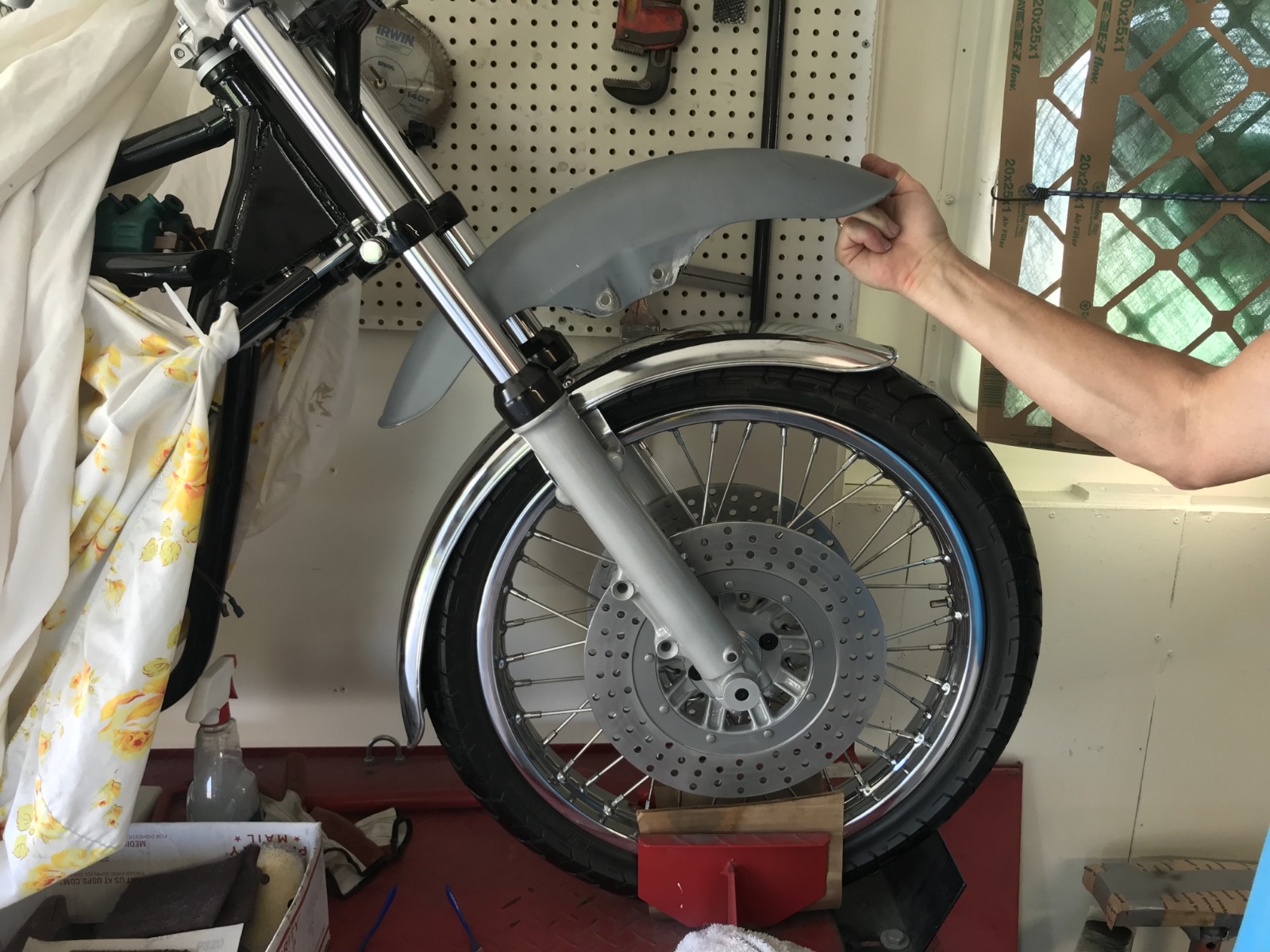

Look for an 18" rim! Or build one! I regret not doing it yrs. ago when I bought the Buchannon SS spokes. I went with 19".
That's if your going old school hot rod style. Old dragbike look.
I am partial to that style myself. I liked the old dragbikes of the 70's and still do.
This is an experiment kZ400 front fender I cut up after this picture.
I might use. Have to finish the fender 1st.
