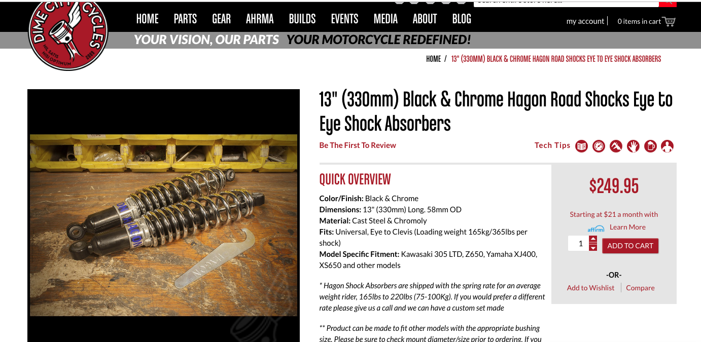

Re: Shocks for a Kawasaki KZ and Video Link
06 Jan 2019 19:54650ed wrote: See:
:laugh: :laugh: :laugh:
I bought some Hagons for my CB750 last year around this time from Dave Quinn. Looks like he got sick and went out of business.
I'll be getting these:
1977 Kawasaki KZ650B
1977 Kawasaki KZ750 Twin
06 Jan 2019 19:57
If you asked me a year ago, I'd recommend hagons too - a friend of mine bought them and they made a great improvement to his bike.
However, his bike isn't kept undercover. Those hagon shocks are now rustier than the 35yo shocks that were on my bike - and my bike wasn't being stored undercover either. The chrome looks great when new but doesn't seem to hold up to weather well.
1981 KZ750 LTD

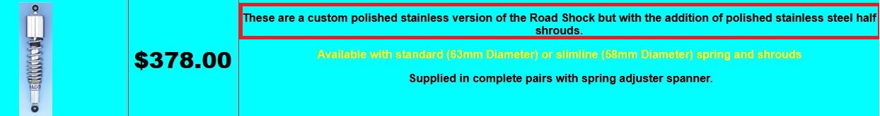

06 Jan 2019 20:53Irish Yobbo wrote: If you asked me a year ago, I'd recommend hagons too - a friend of mine bought them and they made a great improvement to his bike.
Very interesting. The bodies and shrouds of my Hagons are made of stainless steel, the springs have heavy chrome plating, and the adjusters are aluminum. There's nothing on mine that can rust unless someone was to file the chrome off the springs. I wonder if Hagon offered different levels on quality? Ed
- Thanks: 2830
06 Jan 2019 20:58 - 06 Jan 2019 21:00Irish Yobbo wrote: If you asked me a year ago, I'd recommend hagons too - a friend of mine bought them and they made a great improvement to his bike.
Here's a Hagon ad showing stainless ..........
Last edit: 06 Jan 2019 21:00 by 650ed.
06 Jan 2019 21:20
His looked like
these ones.
No shroud, and I can't remember if the body was stainless or painted, but the chrome spring was pretty heavily rusted after a year.
