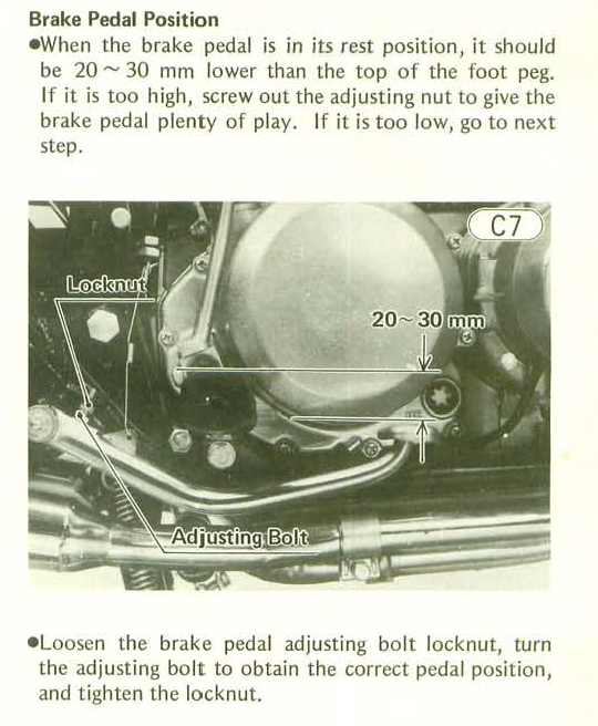

Check your brake pedal and make sure that the (adjusting bolt) is set right , if it is out too far the pedal will not return enough to allow the brake fluid return to the reservoir and pressure builds up in the system holding the pads tight to the disk.

10 Mar 2019 08:59bluej58 wrote: Check your brake pedal and make sure that the (adjusting bolt) is set right , if it is out too far the pedal will not return enough to allow the brake fluid return to the reservoir and pressure builds up in the system holding the pads tight to the disk.
You were right. The pedal return wasn't allowing the pedal to come all the way back. It wasn't because of pedal stop, though. The bolt head for the footpeg was keeping the pedal from returning. I shimmed out the pedal mount (with a large flat washer) and it works fine.
It should not have interfered, but the pedal itself may be bent inward a bit -- as it has a bit of road rash.
Thanks again for your help.
