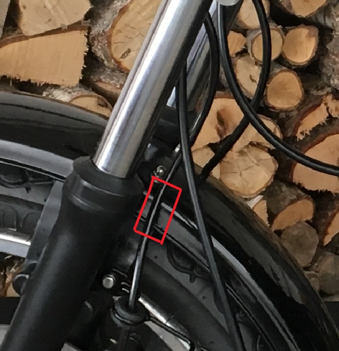

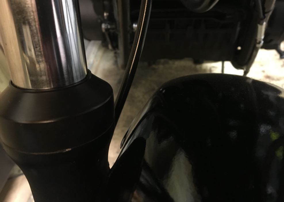

My brake lines touch the mud cover in front when I driving with my bike.
I have tried to find a good solution and I have found one way I think ?
Please see attached photo behind.

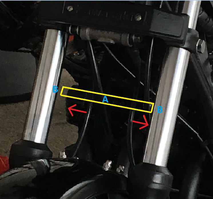

The idea is to use a plastic pipe and then have one cable ties side it and lock the brake lines on each end of the tube.
Then I force a specific distance between each end of the tube ?
Or somebody see other good options for solution?

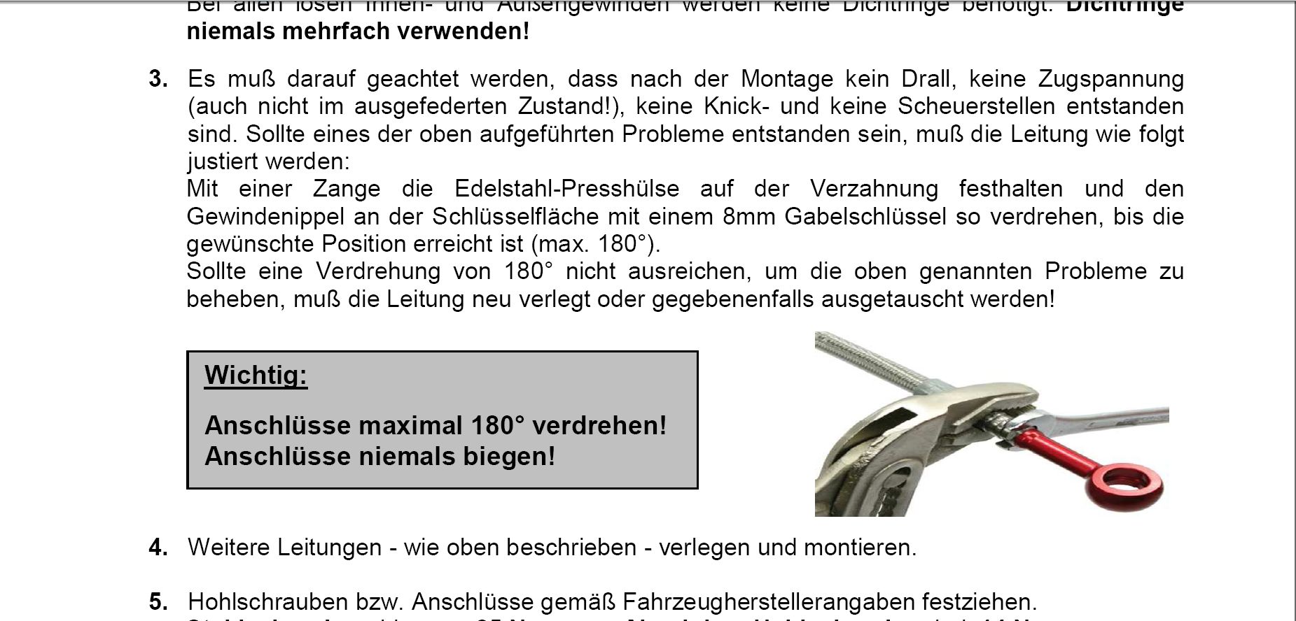

Some brake lines can be turn around max. 180 degrees at the Banjo fittings to twist it away from scratching on other bike parts with a vise grip carfully.

Thank you again, will check these up with the company who made them.
