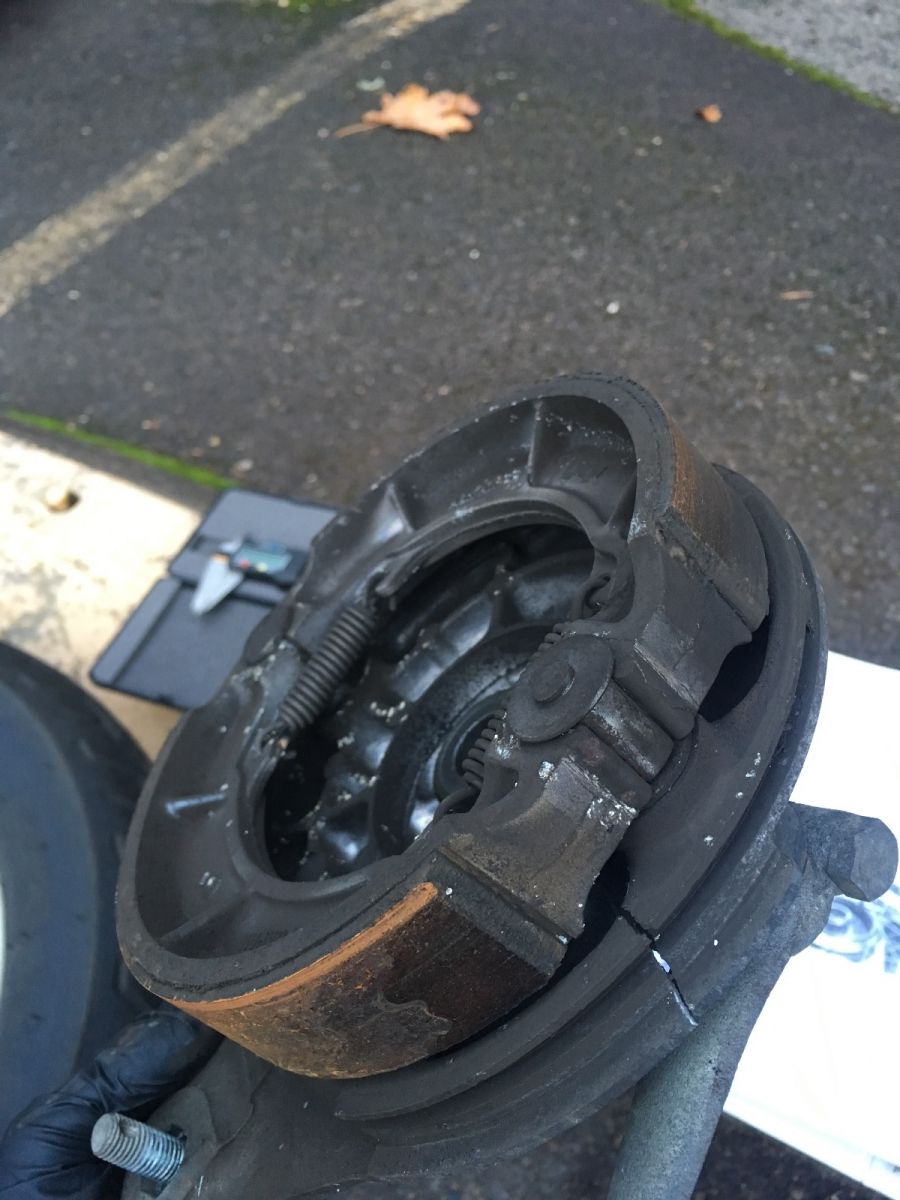

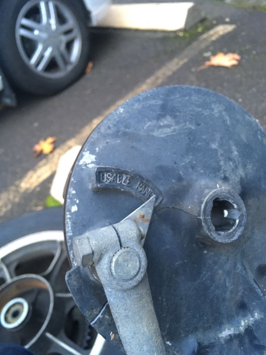

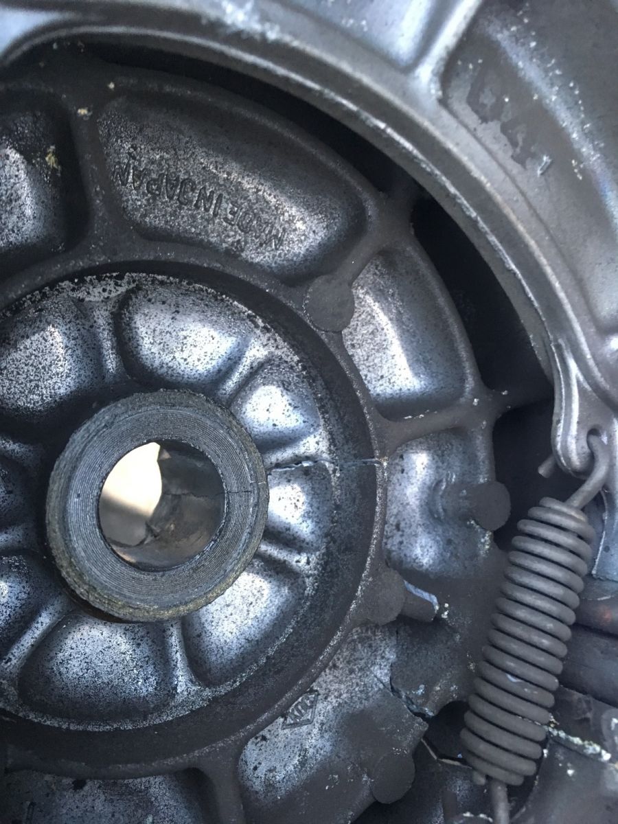

10 Nov 2018 08:18
If anyone was curious, here is what I found.
For starters everything was under the service limit. The drum diameter, the lining thickness, spring length, brake camshaft diameter.
Also there’s a big crack leading from the outside to the inside.

10 Nov 2018 09:31
Looks like that is jacked up in just about every possible way.
Glad it didn't grenade while you were riding it.

10 Nov 2018 21:04
Wow, that could've been deadly. Looks like the side of the shoe was rubbing against the drum too.
