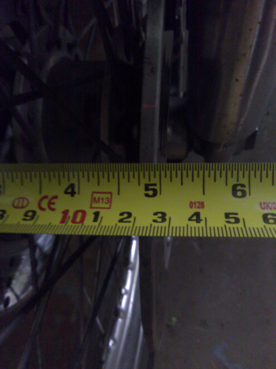

Would someone mind to throw a measuring tape between their front rotors? Could be helpful to do:
Inside-Inside
Outside-Inside
And are these guys setup equal offset on teh left and right?
I have a single rotor wheel so I can guess at what a dual would be... Im trying to retain stock wheel and rotors with the GSXR fork and calipers. rotor diameter is very close just need to figure out rotor spacing.

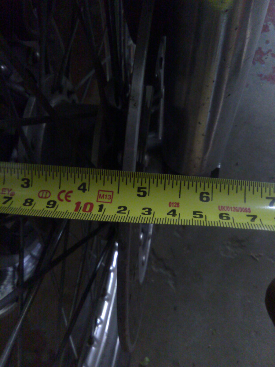

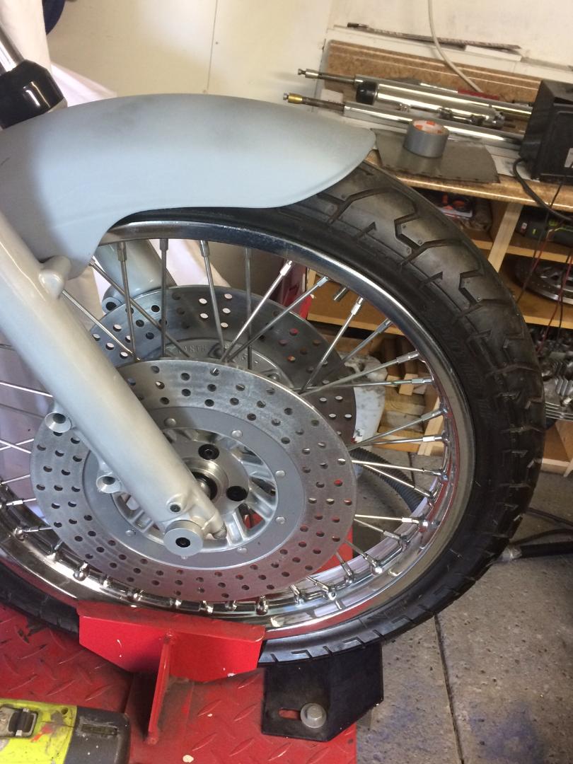

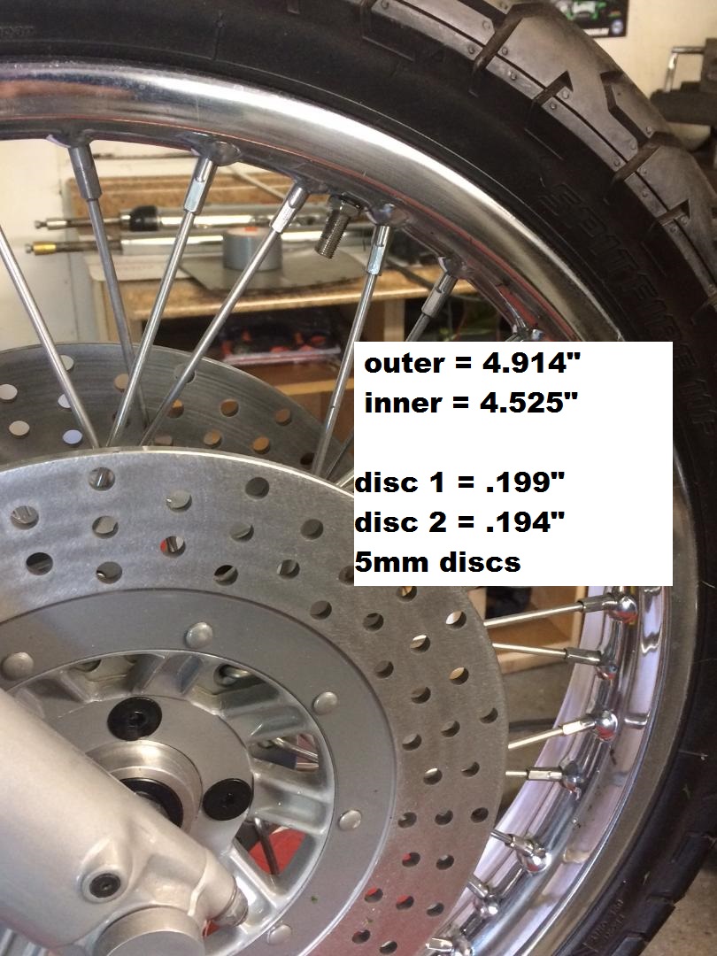

The rotors for a dual disk setup are thinner then a single disk set up

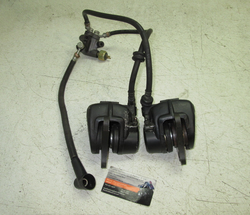

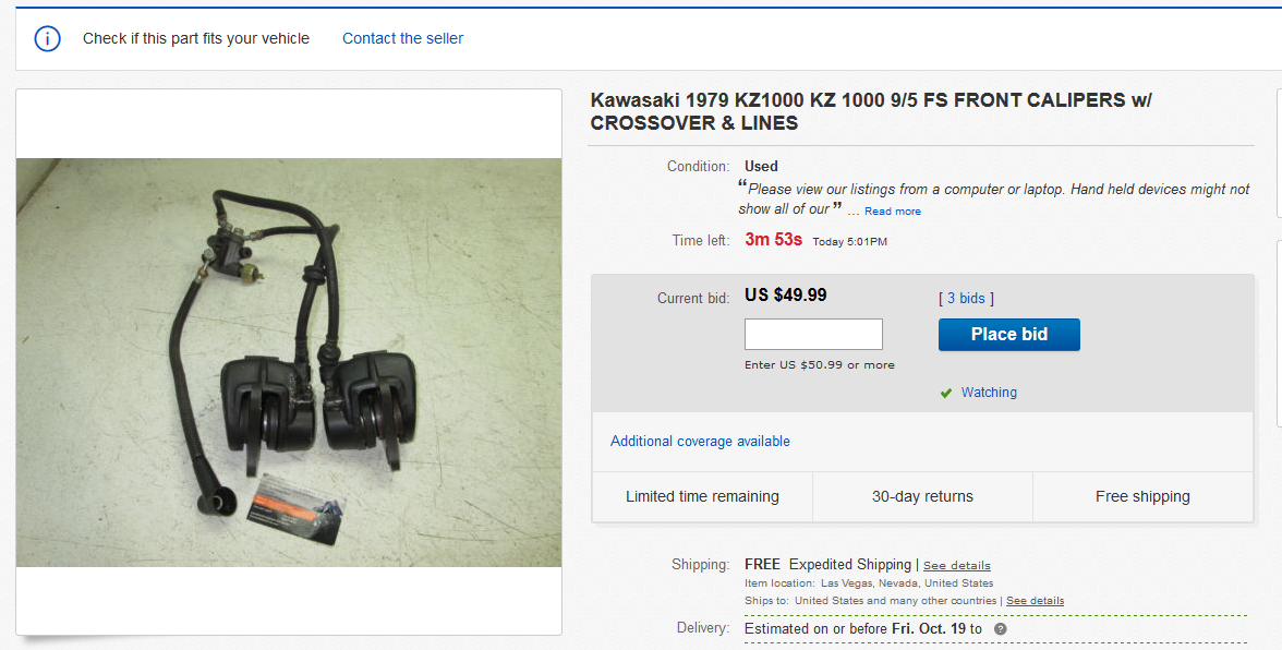

When I converted I found a complete set up on Ebay minus the master cylinder, I found a new 5/8 master cylinder on ebay too
You just missed these but there are others all the time
Winning bid was 86 bucks a good deal IMO
The first is inside to inside and looks like 4 9/16 inches the second is outside to out side and looks like 4 15/16 inches

awesome thanks!
