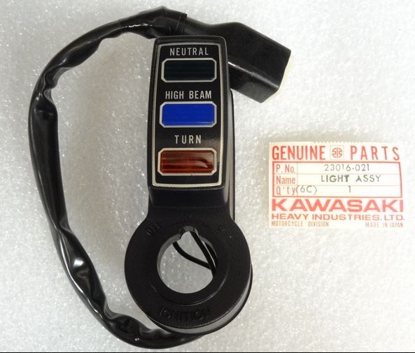

No ,but it's close to it.. .. mine has the oil light in the middle. You gave me the idea to look up the part # and i came up with "indicator lamp cover #25023-1011) there is one on e-bay for about 60 dollars .. I was kinda hoping there may just be the paper decal available

No eBay APP ID and/or Cert ID defined in Kunena configurationThe 25023-1011 pilot cover I saw on EB is labeled: neutral (green), high beam (red) & turn (amber). the high beam indicator is usually blue.
Here's a pilot cover for the 78-79 KZ400-B with neutral (green), oil (red) & turn (amber). part # 25023-1005. ~ $50T.
ps: There are heavy duty stick-on printer labels available, but I don't know if there's anything suitable for use on a motorcycle.

No eBay APP ID and/or Cert ID defined in Kunena configurationIf the 440 pilot covers have decals, then somebody must have put the wrong decal on the second one.
The tachometer for his 440B should have a high beam indicator, so it seems logical that his pilot cover would have an oil warning light.
...25015-1007
...25015-1007

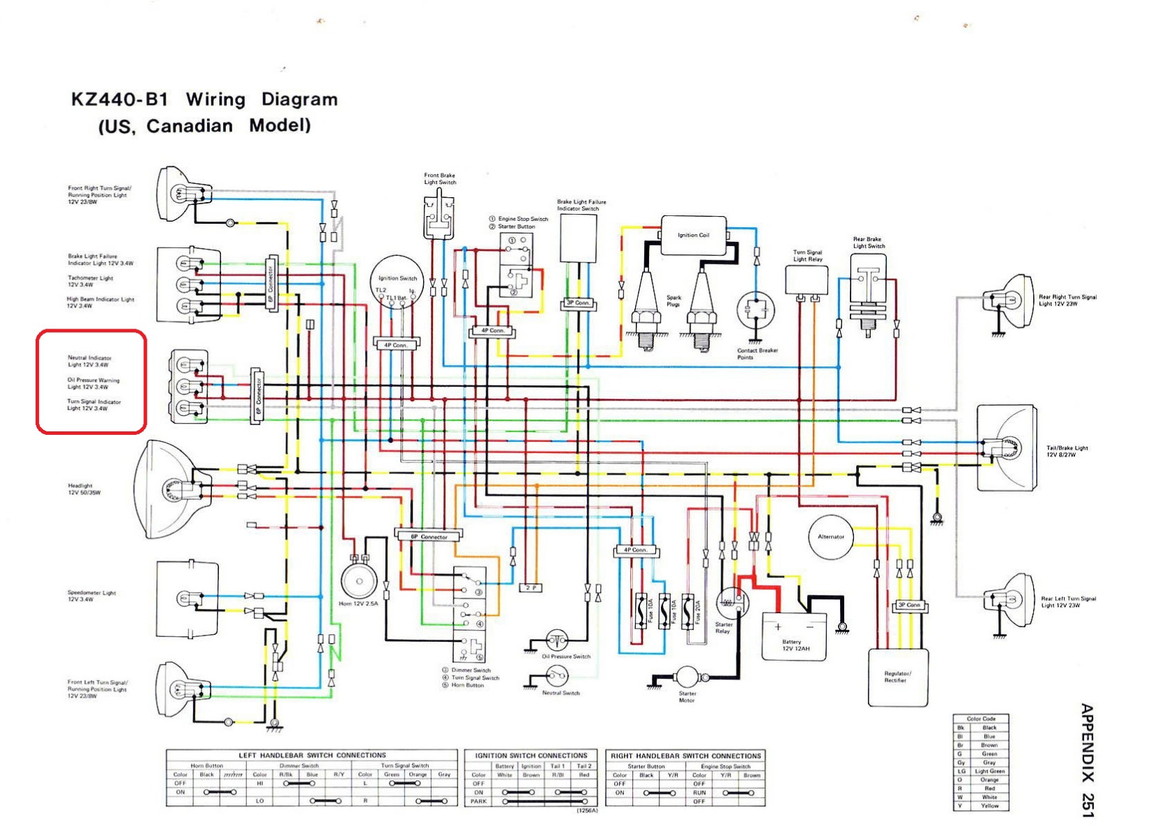

Correct. The wiring diagram for the 1980 KZ440-B1 shows the central cluster with Neutral Indicator, Oil Pressure Warning; and Turn Signal Indicator lights. Diagram below (click on diagram twice to expand it). Ed

Yes, that's the tach... and appreciate the wiring diagram
