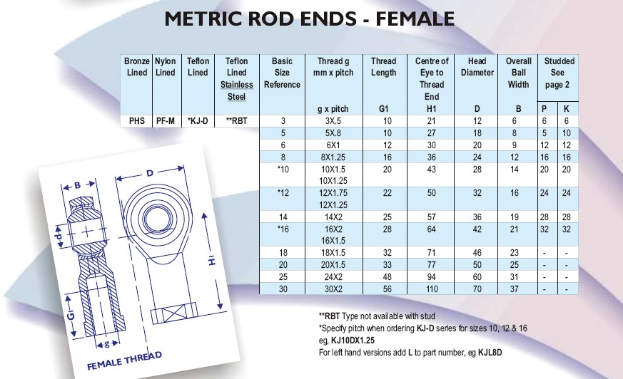

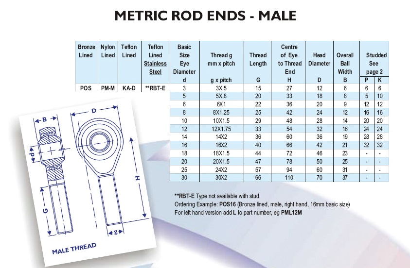

Have you considered using a male and female rod end screwed together. They are available as maintenance free with built in lip seals, you can get m12 rod ends that have the same 16mm ball width as the factory link and will accept the factory collars that reduce the 12mm ball hole down to suit the m10 bolts.
To get the 70mm C-C distance you will need to shorten the male end so it can screw in far enough, otherwise a longer link will raise the back end and change the handling which you may or may not like .

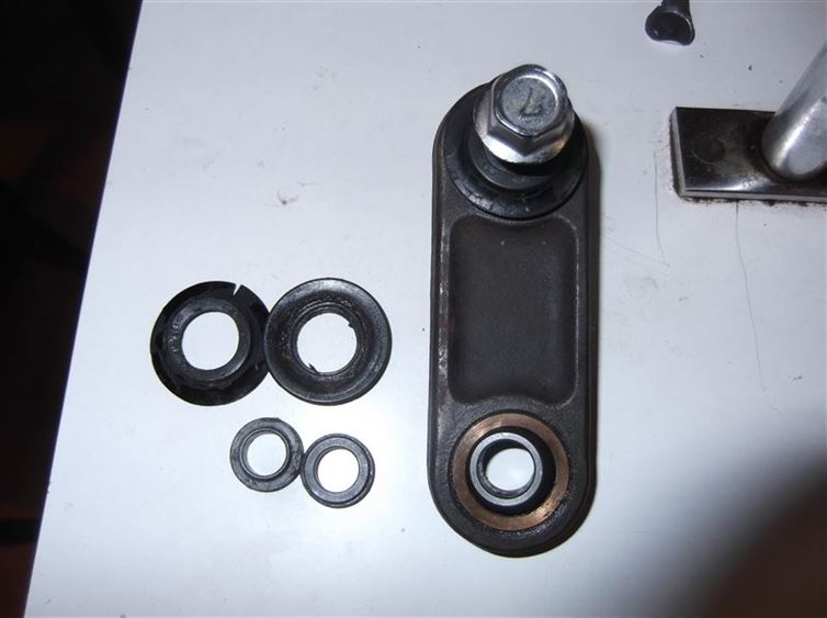

The problem I have right now is that the collars are what is broken.
imgur.com/a/e5mSs3A that's the piece.

OK. Thats a surprise, i wouldnt have expected that being as they are hardened steel. They should be clamped tight between the mount and spherical bearing ball and unable to move. how many are damaged?
The wear on mine is in the tie rod bearing and the seals that go over the collars are not the best.

Buy it now, cheap cheap
Those collars are NLA
