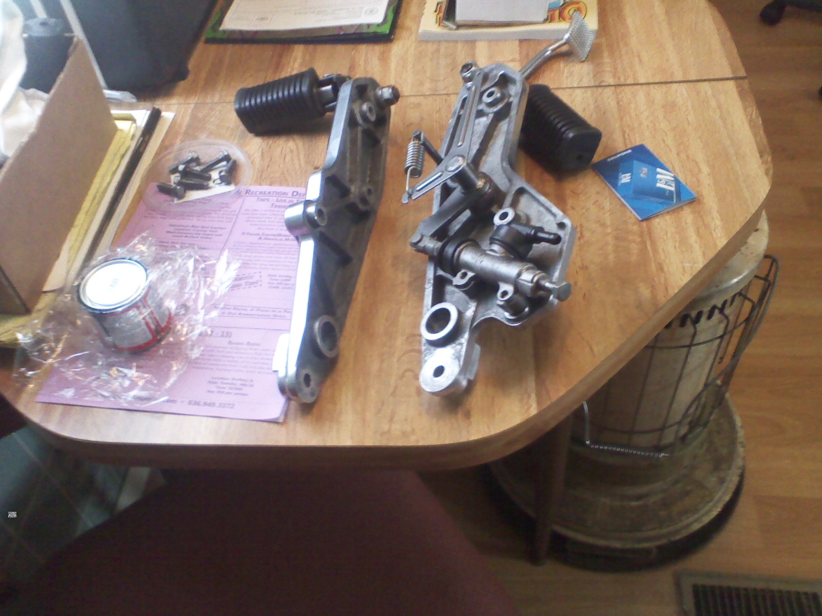

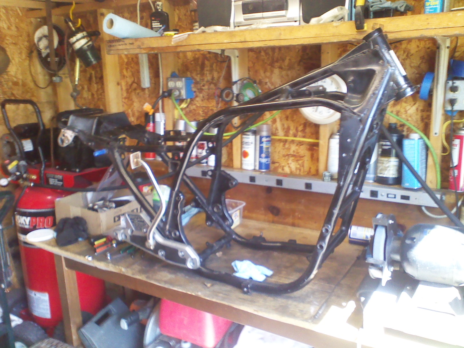

12 Sep 2018 08:44 - 12 Sep 2018 08:53Shasta wrote: I have removed the pedal and cleaned the inside pat of it. I am not sure where to apply the grease. The problem seems to be that the pivot does not turn inside the plate freely. I am not sure how to lubricate this. It moves finally but not freely enough that the return spring would be able to move it.
Texas Kz explained it perfectly. Mine was seized too when I first got my bike. I bolted the right muffler support with brake pedal back on my frame after I stripped the bike down and just kept soaking it with penatrating oil while working it every chance I got. If you have it apart, just clean up the shaft and the bushing good. Perhaps use some emory paper to clean up the steel shaft, and possible some plumbers fitting brushes inside the bushing? Just try not to damage either surfaces so as not to have a now sloppy fit by taking things from one extreme to another, causing a NEW problem.
You lubricate the parts that move, not the splines on the pedal. You need to take the shaft out, just to clarify things. Do you have a service manual? Perhaps look up the individual parts on partzilla?
Notice the right muffler support is the only thing bolted to the frame.
