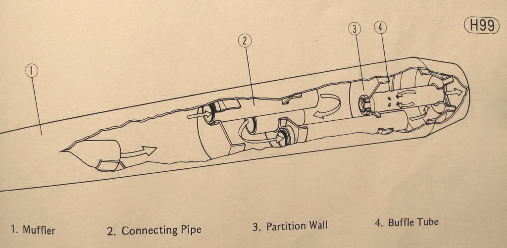

The baffles are probably welded. I don't know about the KZ1000P, but the 81 650-CSR mufflers have an end plate with a tube welded to it, then another plate in front of that which you can see by shining a flashlight inside the muffler tip, then further forward theres another baffle tube (shown in pic).. and maybe some other baffling as well. Some manuals show a cross-sectional drawing of the mufflers.

The last factory exhaust I dissected was a Kz400, and it was like Martin is describing. There would have been no way to "pull out the baffle" as the divider plates and tubes were all welded in. We had to cut the muffler apart to see the inside.
If the original exhaust is in good condition, I would recommend getting an aftermarket exhaust to experiment with. If the old system is rusty and the mufflers are pitted, you might try to cut them off and weld on mufflers that have removable baflles. (That is, assuming the factory exhaust is like the other factory exhausts where the baffles are not removable.)

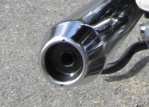

The muffler in question might be different, but here's how the KZ650 muffler is made. Those partition walls are welded in place, so I see no way to remove a baffle without wrecking the muffler. Also, there are no removable end caps. The ends of the mufflers are formed and welded into one piece (second image below). Ed
Last edit: 08 Sep 2018 10:30 by 650ed.

Re: Exhaust baffle
08 Sep 2018 14:11
Yeah, that's what mine look like. May end up getting good some aftermarket. Don't want it annoying loud, just a bit more throaty.
