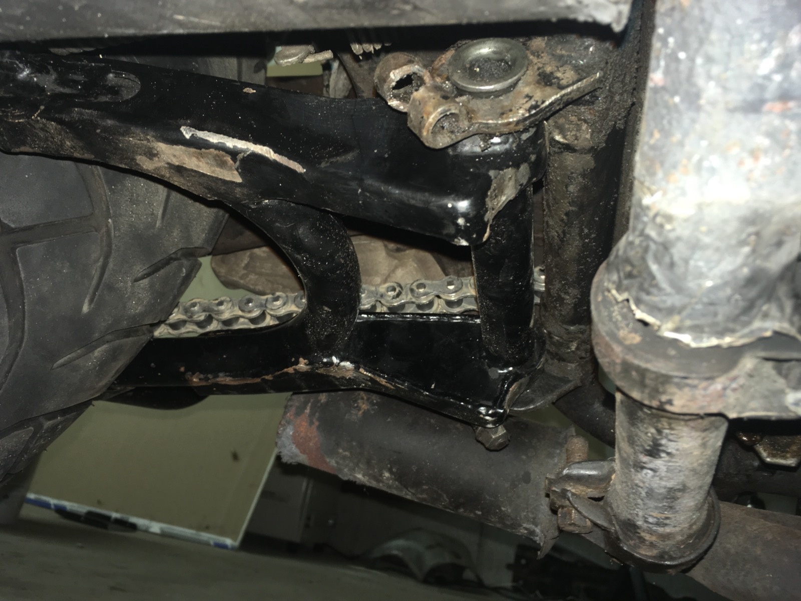

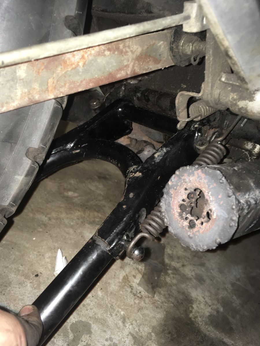

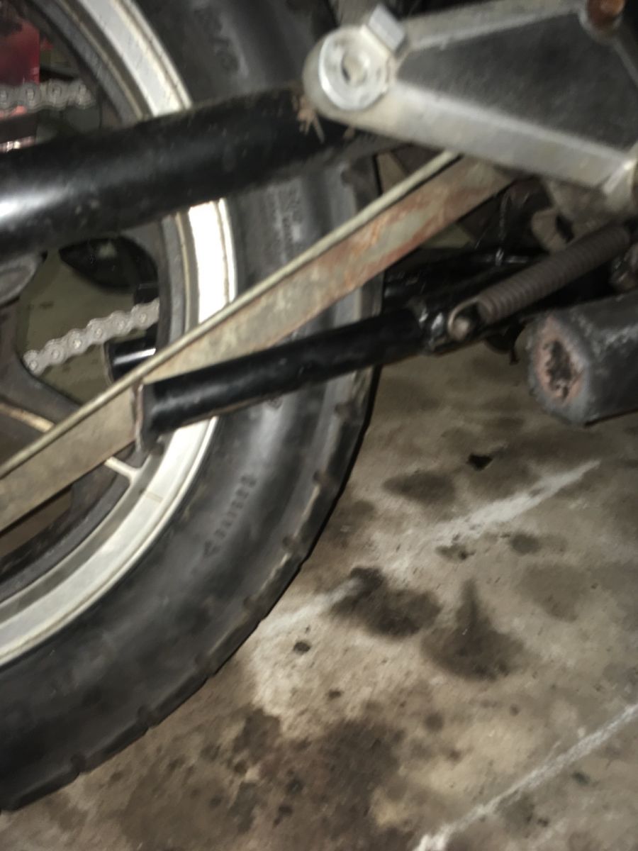

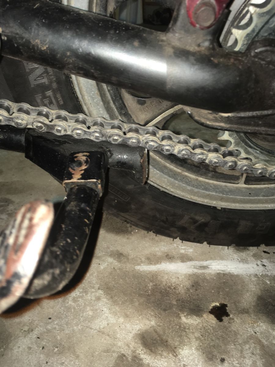

I’m back with more problems!! My kz550 C3 again. Just ordered a center stand, came off same make and model. Just put it on the bike, but when it’s up it’s rubbing on the chain. Pictures show what I mean. Any advice?

It didn't look as if there is a stop for the center stand. I went through the same thing on my 78 LTD because the bike didn't come with a center stand -- hence, no stop. But I can't be stopped either so I made a nice stop out of a chrome open end wrench but I don't suggest you do this because the foot portion looks low as it is. I will remove the stand on my bike after I'm done working on it. I'll put it back on as need be for working on it. Center stands are handy but that's the way it goes. Are you absolutely sure your bike came with one from the factory? Stake your life on it sure?

The stock exhaust system would have a stop on the bottom of the left side muffler or muffler bracket. Since your bike's stock exhaust is gone so is that stop. A couple folks on this site have come up with very good solutions to the same problem and they posted photos of their fixes (see link below). Maybe they will chime in on this posting. Ed

Togoster: I’m 150% positive. Has the brackets for it and everything, but the stopper is what I’m missing. Ive been looking for a full exhaust, the PO Put that crap exhaust on it before I bought it. It’s been irritating me ever since, but hey I bought it with the bike so I can’t say too much.
650ed: I’ll be looking at those links for sure. Chances are I’ll keep it off until I get a new exhaust, but at least I know I didn’t mess something up!!

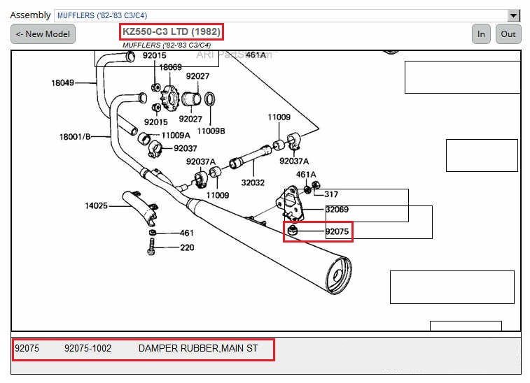

If the muffler stay is missing, you could install that & the LH muffler bracket as the bracket also serves as the center stand stop. already mentioned above.

Calvin9819 wrote: ................ Has the brackets for it and everything, but the stopper is what I’m missing......
If you are only missing the rubber stopper you can get one from eBay. Ed

Z1Enterprises has a center stand stopper. not sure of the fitment to the 550. Z1Ent ---Damper - Main Stand - 92075-015
