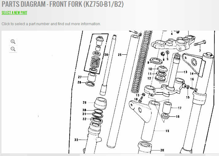

07 Aug 2018 06:41 - 07 Aug 2018 06:42Leor13 wrote: Hi,
.......... I dont want to stick to the OEM forks since it has the attached headlight bracket and I dont want that...........
I don't understand. If you don't want the headlight brackets can't you just remove them when you have the forks out of the triple tree. They are separate parts as shown in the parts diagram below. Ed
