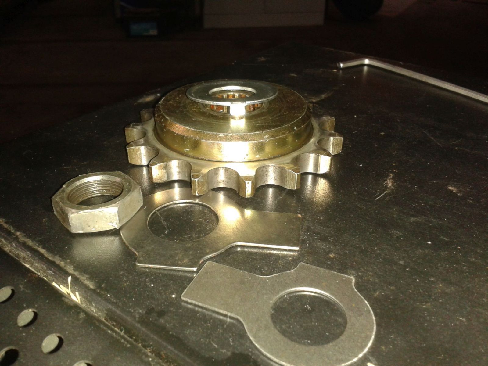

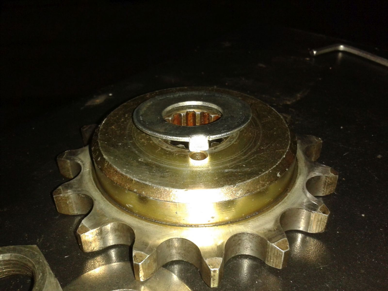

He will need a min. 10 mm front offset sprocket, anyway what kind of swing arm/wheel (5.50 ") he want to use with a 180 tire.
