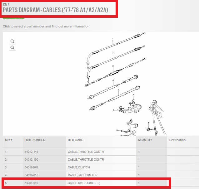

The 1977 KZ1000-A1 is NOT the LTD model, and according to Kawasaki it uses Part Number 54001-040 for the speedometer cable.

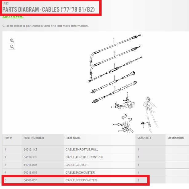

The 1977 KZ1000-B1 is the LTD model, and according to Kawasaki it uses Part Number 54001-057 for the speedometer cable.
Notice that the two part numbers Kawasaki specified are different. If the speedometer cable for the KZ1000-B1 LTD was the same as the one for the KZ1000-A1 (NON-LTD) do you think Kawasaki would have specified two different part numbers for the cables? Ed

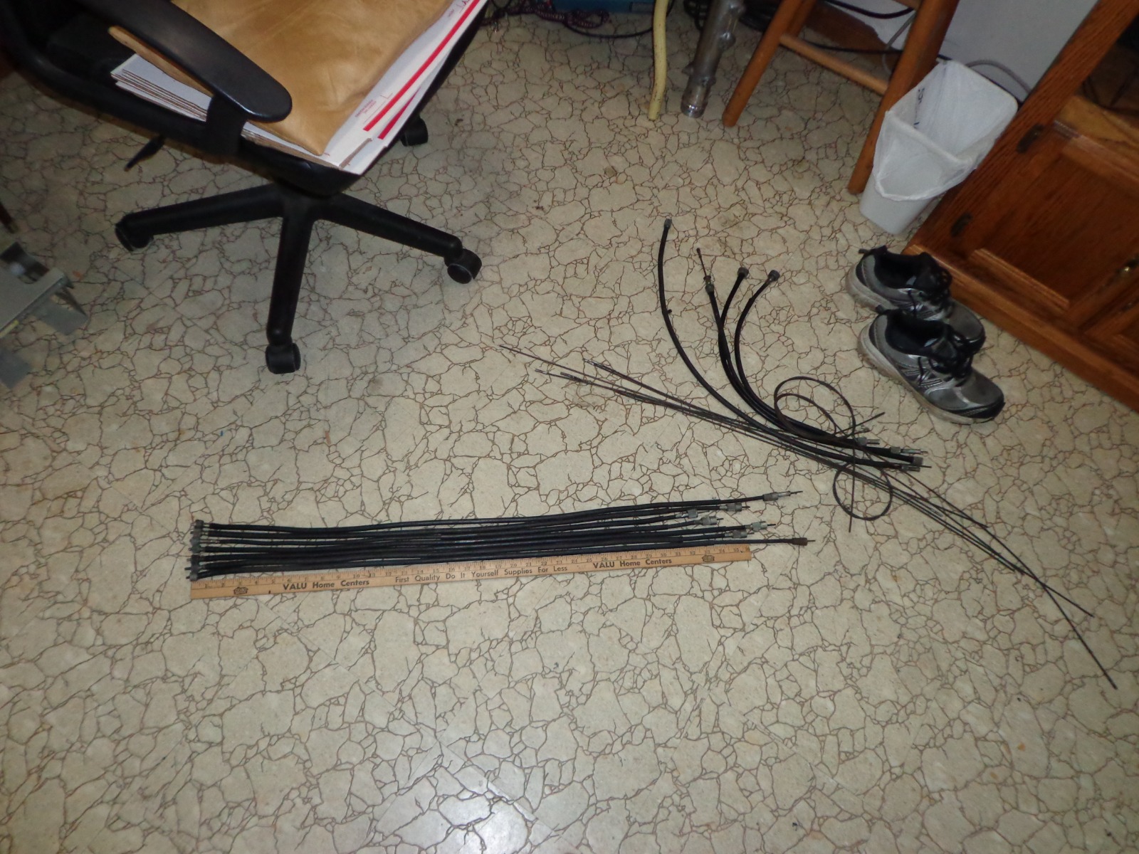

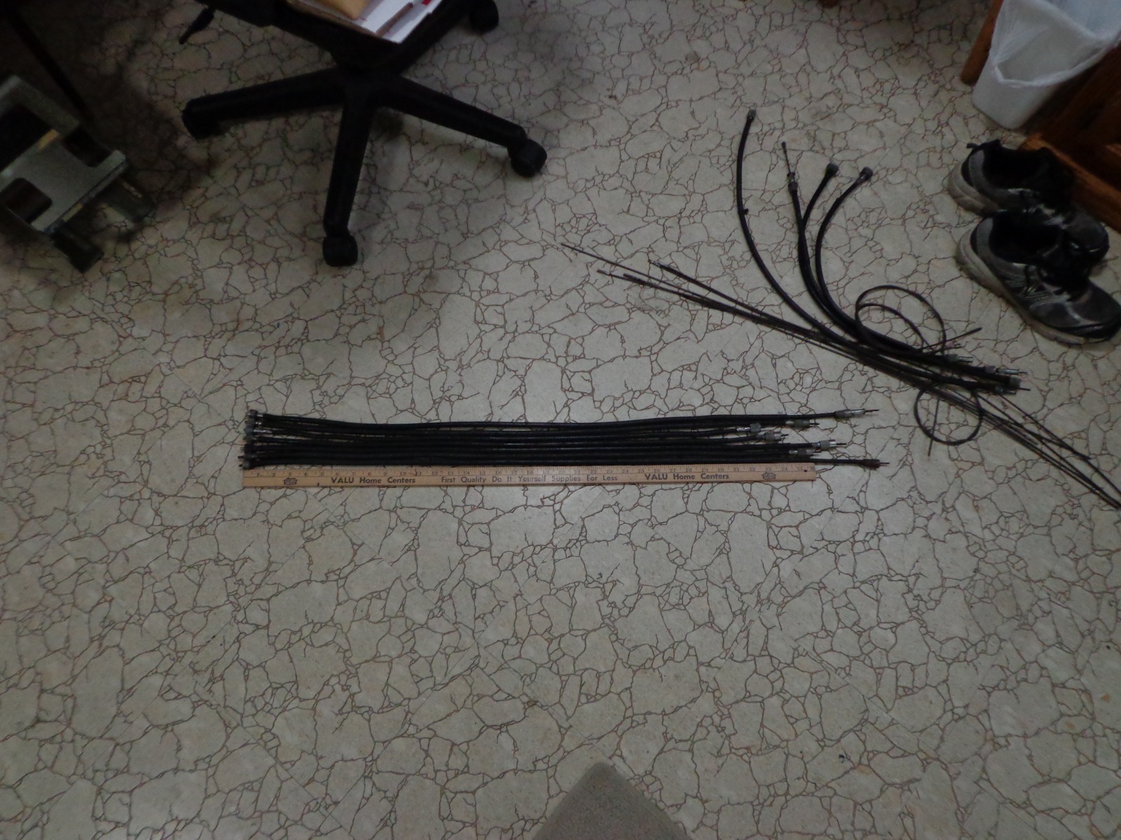

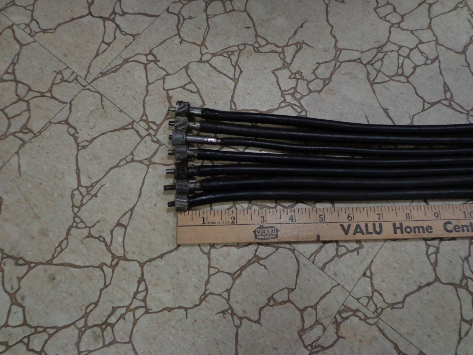

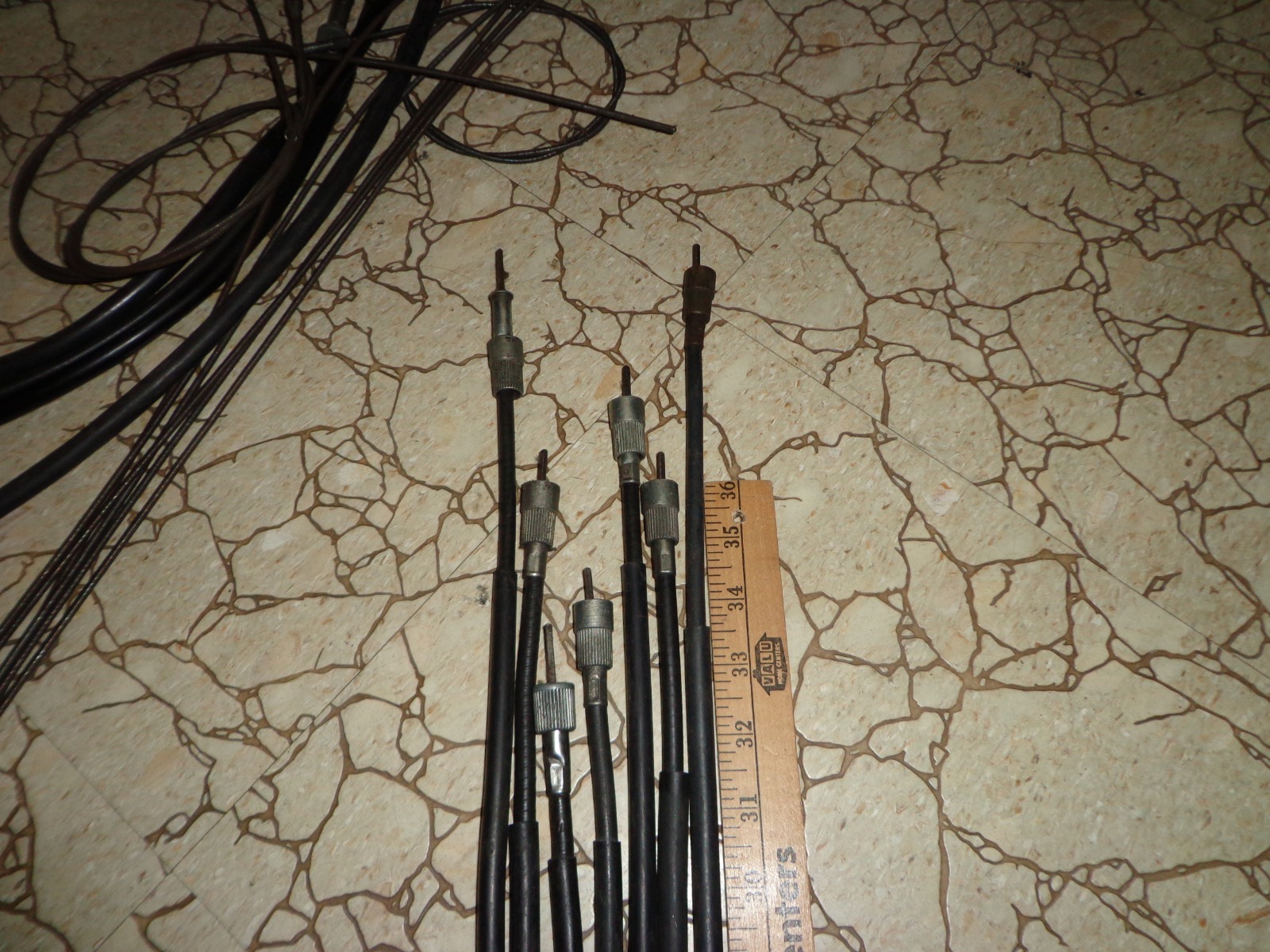

I laid a pile out on the floor against a yard stick, and they are all different? WTF??
I have no clue? I have had these for ? Many years. All mine were Z1-KZ's
But there are a couple 36" They range from 33" to 40"
I see your PM Wilcocar. I'll send you the 36" if you want one.
