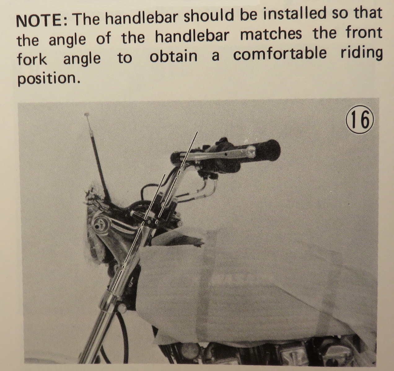

I find my stock KZ650-C1 handlebars to be very comfortable, and the B2 came with the same bars.  Are you sure yours were properly adjusted (see image below).  I ask because I have seen quite a few bikes with the bars rolled forward which I would think would be very uncomfortable.  Ed

650ed wrote: I find my stock KZ650-C1 handlebars to be very comfortable, and the B2 came with the same bars.  Are you sure yours were properly adjusted (see image below).  I ask because I have seen quite a few bikes with the bars rolled forward which I would think would be very uncomfortable.  Ed
i am looking for some that are shorter than stock. the stock ones were bent when i got the bike
