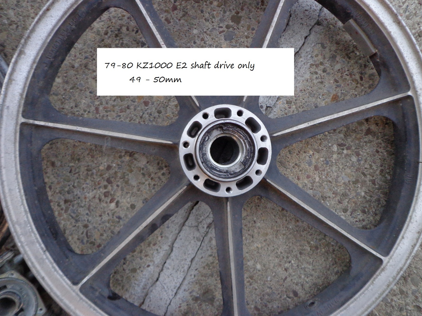

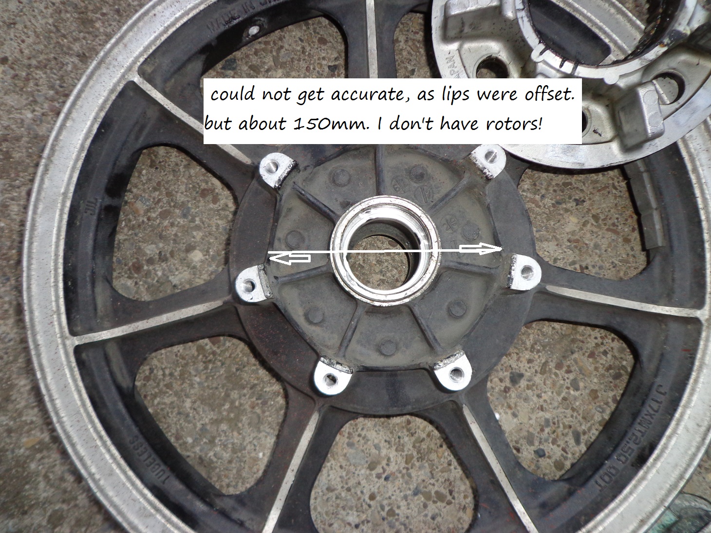

I will check this evening as I am scrapping a set of KZ E2 shaft rims! As no one wants to buy them?? I will measure the brake area diameter for you.

Forgot, been awhile since I seem them. But partzilla listed them as 79-80 E2 shaft drive only.
I tossed the rotors out a year ago for scrap. So I could not get O.D. These rims are going to scrap today.

Thanks for sharing these @z1kzonly. It turns out the rotors I need have a 168mm inner diameter.
