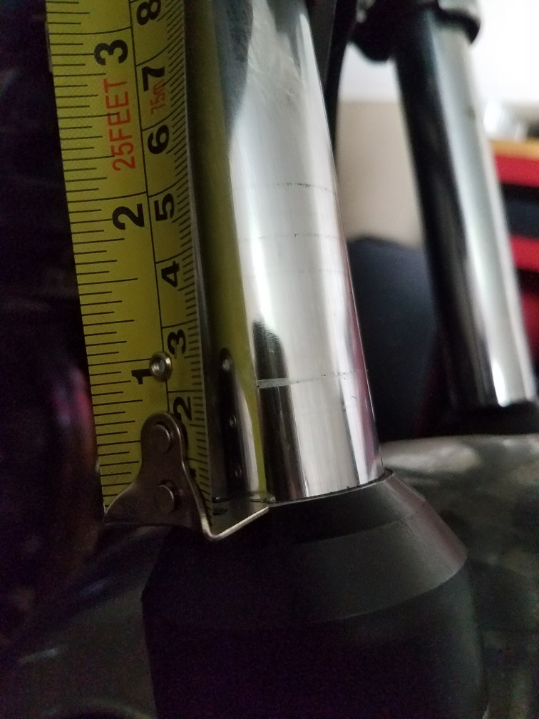

on the center stand they don't really move when i lean forward or back. normal use is around 30 mm on both with highs of around 80mm on the front from hard braking. this is me measuring the wear lines on the rods as well as getting on and watching them while i rock the bike. i know it's not the best method, but it is what i have atm.
EDIT: on my f800gs i rub on the center stand on both sides when turning. on my kz900 i rub on the engine protection bar when turning right and on the header which sticks out a little further than the epb on the other side.
i took measurements with pictures by taking the bike off the center stand and leaning forward and back. i marked the travel using a silver sharpie, then measured the travel with weight off the tires on the center stand.

I just saw your pics. If I understand correctly you have about 20mm from completely unloaded to bike weight alone, ie, not on any stand, but without rider. If so, I think that is about the most you want. Measuring with you on it will require helpers. Only the unladen(fully extended) measurement uses a stand. Bike alone and bike with rider have to be taken with stands up, or you will get bogus readings.

22 Jul 2018 16:14 - 22 Jul 2018 16:18TexasKZ wrote: I just saw your pics. If I understand correctly you have about 20mm from completely unloaded to bike weight alone, ie, not on any stand, but without rider. If so, I think that is about the most you want. Measuring with you on it will require helpers. Only the unladen(fully extended) measurement uses a stand. Bike alone and bike with rider have to be taken with stands up, or you will get bogus readings.
Conacting Nils is a good idea.
20mm is with me on the bike vs unloaded. i leaned forward to mark the front and sat on the back of the seat for the rear.

After you are rested, read the article I linked to. Leaning forward and sitting on the rear of the seat will give bogus numbers. To get correct numbers, both stands have to be up, your feet need to be on the pegs, and your butt and hands need to be in riding position. That is why you need two friends. One to balance the bike, and one to measure.
