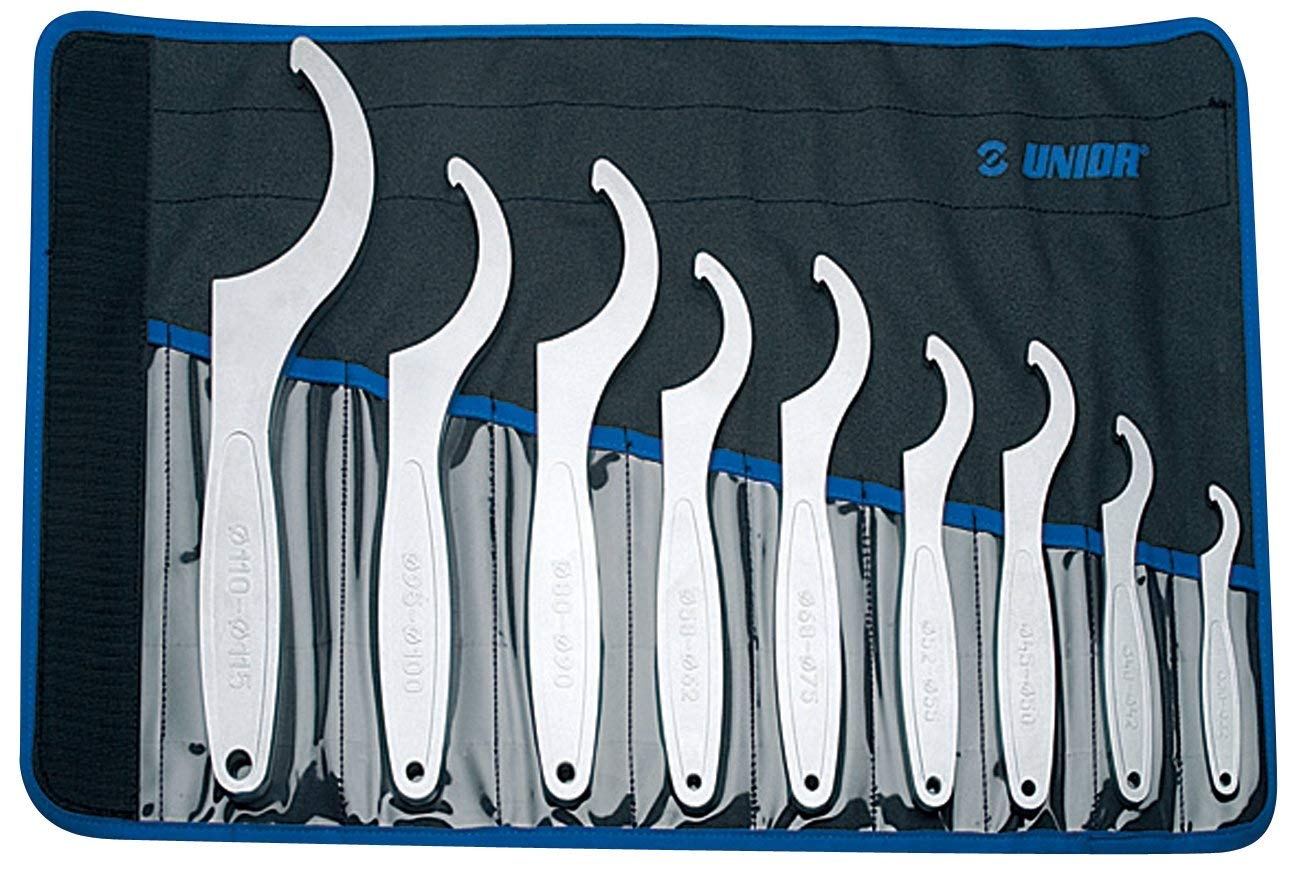

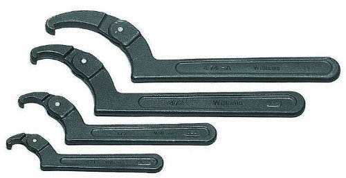

I can grab one of these wrenches from a motorcycle shop of some sort right? Like Cycle Gear or something?

It´s a simple hook spanner and nothing special you should can buy in a good iron/tool hardware shop for less than 10 Dollar.
