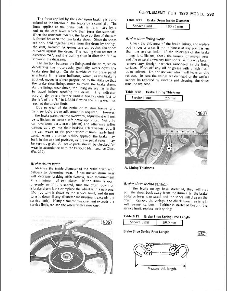

I just hope my brake drum isn’t too worn out... I would hate to buy a new rear wheel, it’d be hard to find one with a rear drum that’s in good, in spec condition

Re: Brake drum
20 Jul 2018 19:59
How bad would it be if I still used my brake drum, even if it’s just barely past service limit? After turning, it’ll probably get just barely to service limit
- DoctoRot
- Posts: 2623
- Thanks: 787
Re: Brake drum
20 Jul 2018 21:09
As long as you're within the service limit I would say you're fine. hell even a little bit out probably wouldn't make a difference at all.

i don't have tools to measure unfortunately. Ill be picking them up at some point but funds are low. I can get some pictures up soon. I dont have a frame of reference, I measured with a tape measure but it was rough cause the center was too high up, the tape measure would bend. from what i estimated, it was just barely passable. But I'm not for certain

23 Jul 2018 11:39
The machine shop that turns the drum will have the necessary measuring tools. If not, don't do business with them. Also, if they are willing to machine the drum past its service limit, don't use them.
What could go wrong with a drum brake on a motorcycle? Anything that could go wrong with a drum brake on any vehicle.
Yes, it can over heat. That is the main reason they are not used on modern motorcycles. Also, the lining can come loose from the shoes. Martin_CSR has some personal experience there. If the surface of the drum is groved, uneven, badly pitted, or out of round, braking performance can be compromised and there may be accelerated lining wear.
Personally, I rarely use the rear brake, but when I need it, I want to be absolutely confident that it will do what I expect. I try to avoid pain when I can.
