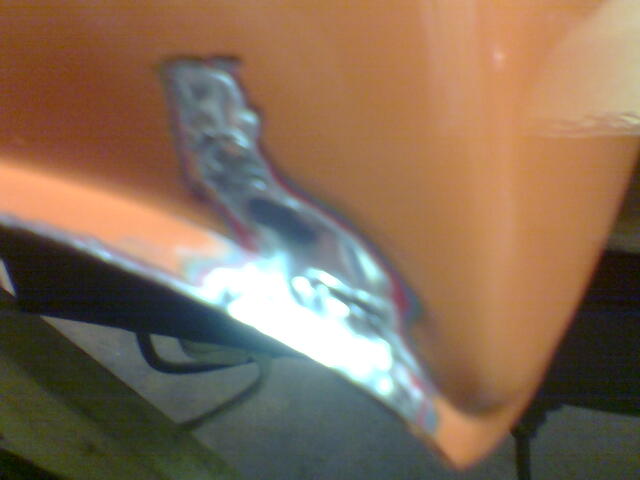

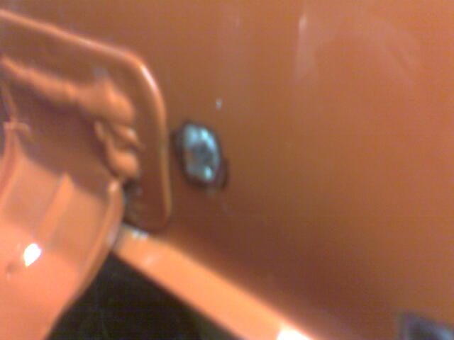

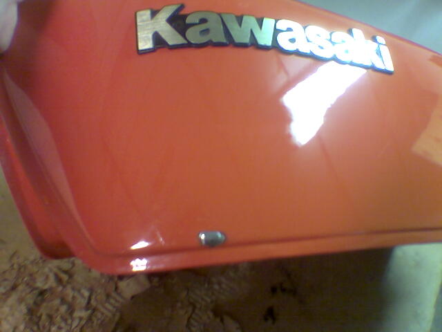

11 Jul 2018 17:09That is exactly what I used... though nothing that fancy.Scirocco wrote: A big soldering iron and tin is the ultimate weapon to close pinholes.
Several days after getting a tank professionally painted, it developed several pinhole leaks. I was not very happy to say the least.
But having done quite a bit of soldering ever since I was a kid, I felt I could give it a shot.
I found a 1/2" rod of bronze and stuck a wooden handle on it and cut it at about a 45 degree angle to give it a tip, and ground it smooth.
I heated it red hot and stuck it into a small puddle of gasoline to see if it would ignite. It did not.
Next I used a small piece of sandpaper to sand the paint down to the metal in a tiny spot centered on the pinhole leak.
I filled the tank most of the way with water and situated the tank so a bubble of air would form where the pinhole was.
Then I used some plumbing acid flux on the small spot keeping it off the paint.
I heated the rod and tinned it with lead-free solder.
Then I heated the rod again and placed the tip right on the bare spot and fed in some solder. The solder naturally flowed then formed a smooth little patch over the bare metal right up to the paint. The paint did not get burned that I could see. I think the temp was just right to melt the solder, and the water in the tank prevented the metal from getting hot enough to burn the paint.
There was one area that had extensive pinholes, but luckily that area is covered up by the seat. Only one little pimple of solder is visible on the tank normally. Most people don't seem to notice it. It's shiny and I guess even though it's a different color, it blends in. I've never had anyone ask why there was a solder bump on the tank.
I didn't have too much hope for this repair, but it could not have gone any better. 6 years later the repairs seem to be holding just fine.

Re: condensation Remover
12 Jul 2018 08:06
It's strange. I tested the tank before getting it painted, and the inside was very clean. As you can see from where the leaks were, they were in areas that would be very hard to inspect. I think there must have been a few rust spots that came close to the outer surface and when the shop did some light sanding etc, they must have just nicked away enough metal that gas could bleed through. The leaks were very slow, more like a wet spot where the paint flaked off. They didn't really drip. I took a a small awl and poked at the spots and found they were pinholes, but the metal was very solid around the pinholes.

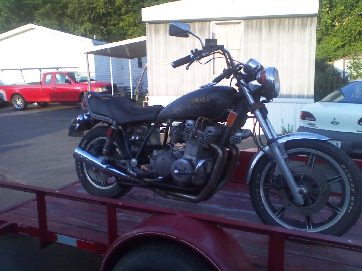

12 Jul 2018 09:05 - 12 Jul 2018 09:30loudhvx wrote: It's strange. I tested the tank before getting it painted, and the inside was very clean. As you can see from where the leaks were, they were in areas that would be very hard to inspect. I think there must have been a few rust spots that came close to the outer surface and when the shop did some light sanding etc, they must have just nicked away enough metal that gas could bleed through. The leaks were very slow, more like a wet spot where the paint flaked off. They didn't really drip. I took a a small awl and poked at the spots and found they were pinholes, but the metal was very solid around the pinholes.
I had one tank that was coated on the inside somehow, and it was a total mess, so I generally stay away from kreme etc.
After 6 years, I haven't had problems with it so far...knock on wood.
Water settles out on the bottom.. and specifically into the seams and low spots, then eats the metal. Those are almost the same spots the XS1100 tank rusted through in the pic I posted above. Along the seam and the rear mounting bracket spot welds. It is just high enough to oxidate the metal after the gas / water evaporates over a period of years. I estimate that the XS1100 sat ~10-15 years judging from the 1998 MO plate that was on it. I bought it in 2012.
