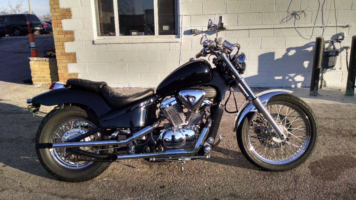

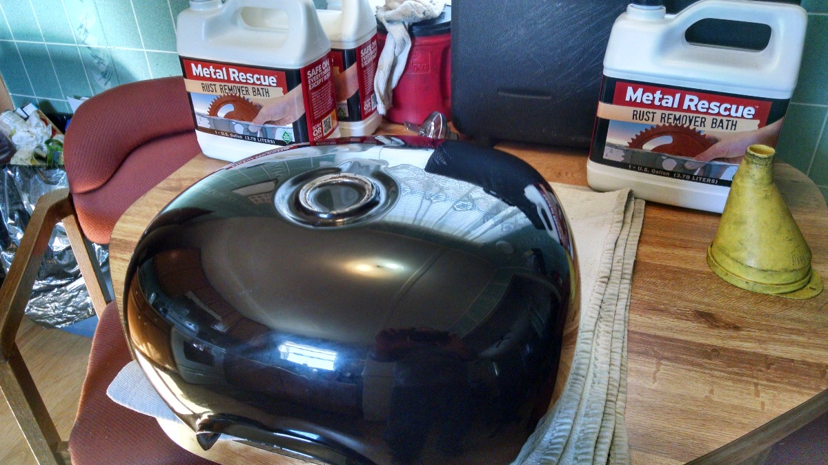

This is a Honda VT600 tank I cleaned for a friend. As you can see, the paint needed to be saved, and It is still just this nice.

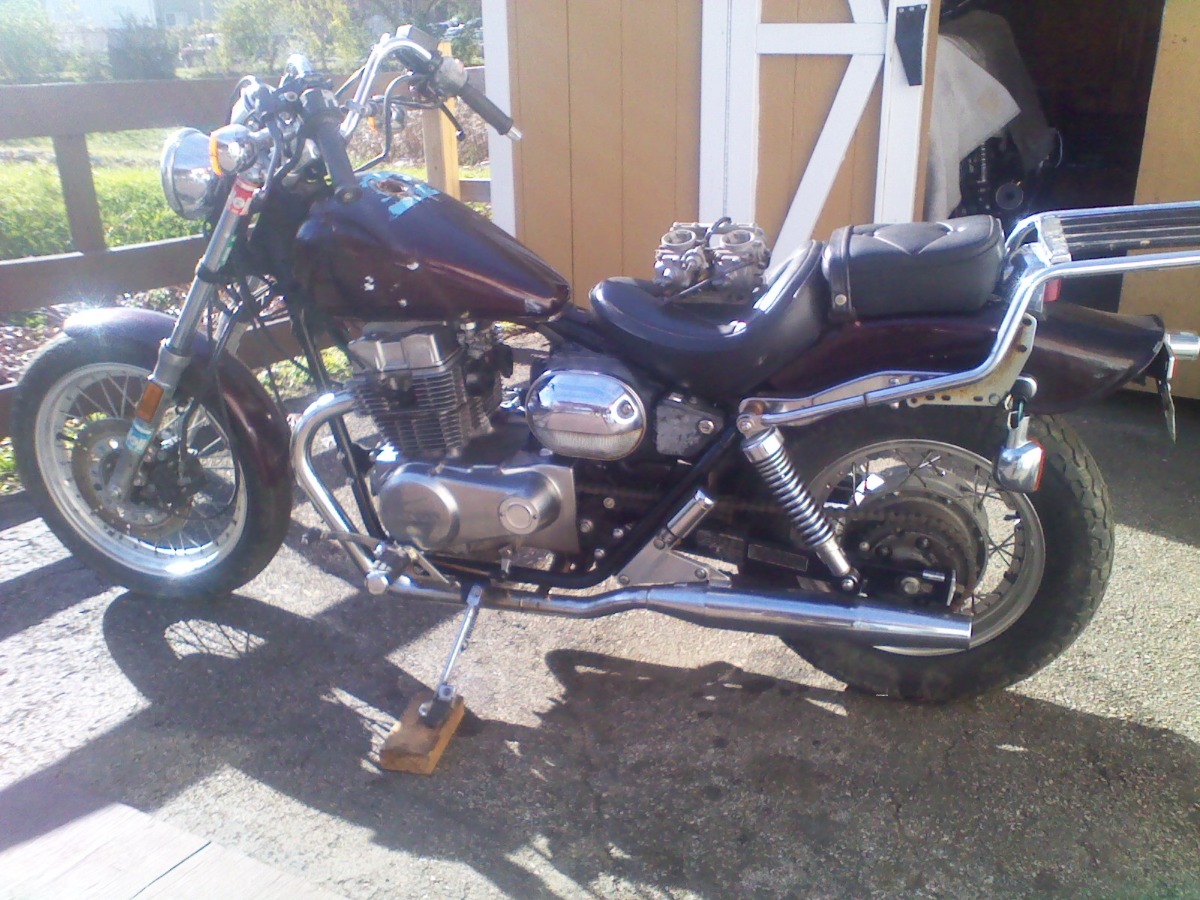

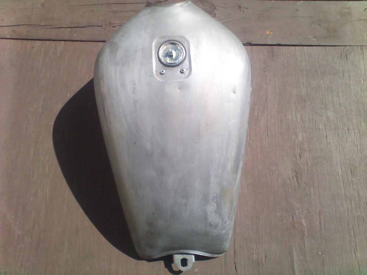

This is a 86 honda CMX450CM gas tank that I cleaned up a few years ago. This one was hard to seal the filler neck with an expanding rubber plug. I used a small square piece of rubber to fill the gap.
Another no title , no keys, locked up tight. Notice the carbs off.. this is how it sat outside for at least a year before I got it. He had a rag stuffed in the carb holders, but then it sat with nothing over it in the elements (was my neighbor). This was a nut and bolt rescue too. This pic was taken the day I got it. Notice the masking tape gas cap. There are some real rocket surgeons out there that own DEAD bikes.
I told him he should at least cover it up, but he said he had a rag in the ports so it would be fine.. NOT! lol I had to break the cam to get the head off.
This motor had 450 miles, I bought it from a guy that answered an ad, but had to drive to Memphis to pick it, and a bunch of other parts up for the restoration.
And the final assembly.
A few parts I bought in Memphis. The frame was some sukzuki that went to the scrap man after I took that new motor out of it.
And it's ALIVE! Off to get a title in Jeff City. Easy peasy!

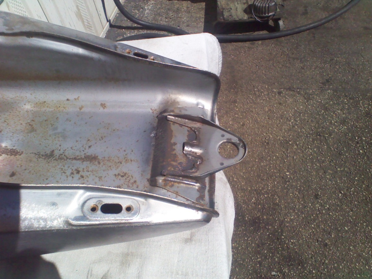

I have cleaned up several extremely BAD gas tanks, the worst being this XS1100SG tank I did years ago. I did electrolysis on that one.. When the rust relocated to the sacrificial metal, several holes opened up. One of the few times I have used JB weld to repair a tank, but it held up. Rusty sheet metal is usually too thin to weld or braze.
There were a few pinhioles around the mounting bracket, and to the left of the petcock locations in the "dip' at the tank seams.
