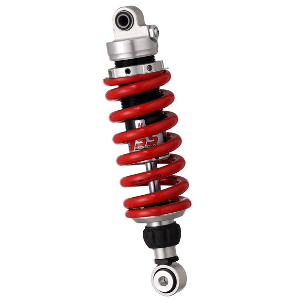

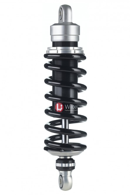

I plan to replace the rear shock on my bike, i knew it wasn't in the best shape when i first rode the bike but i had other things to deal with at the time, I looked into using something from a different model but lost interest and will just pay for something made for the bike
From what i can tell my options are limited to
YSS
Hagon
Hyperpro
Wilbers
Bitubo
The YSS is the most budget friendly of them and has spring preload and rebound damping like the others but ive just about ruled it out
Any opinions on the brands welcome

I like those YSS shocks.

08 Jul 2018 05:33Nessism wrote: I like those YSS shocks.
Yes they look alright, I sent an email to a company over here asking about differing rider weights but have not heard back from them .
From what i have read it seems like they can come with a softer spring than std. with no options for customising your order like hagon or the others do ,
If its going to cost me more to do this then i might as well look at the other options
Not that theres many for these models

12 Jul 2018 20:38 - 12 Jul 2018 21:59Not having much luck With YSS. I found a local company selling them but he seemed confused that I wanted to change the spring.
Looking interstate or overseas now as no one here seems very interested in my OLD bike and helping me
Looking at Bitubo or Wilbers at least I can get them sprung for my weight
