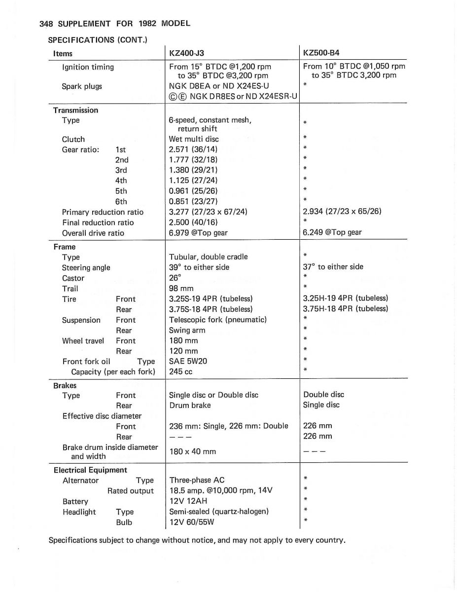

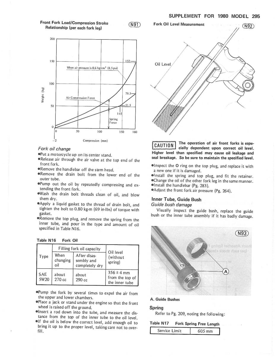

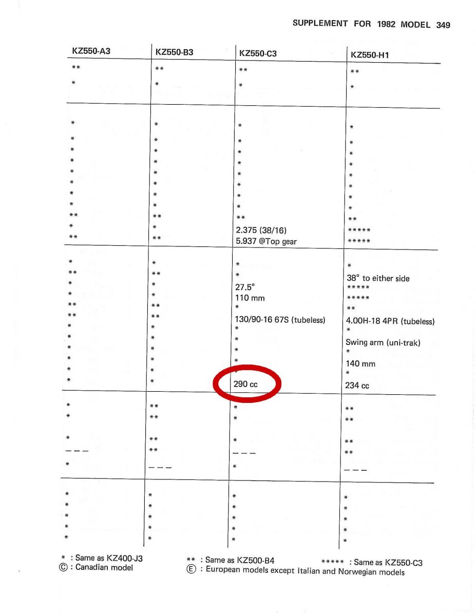

The FSM is known to have contradicting information regarding fork oil level in the Kz550C. The third party manuals also mirror the errors.
You may have to do a google search on the subject to find the correct info. There was a lot of discussion of it on Kzrider over the years.
kzrider.com/forum/5-chassis/602836-kz550...fork-oil-measurement
The 550 also has a slightly different measuring technique than some other Kz's. The 550 specifies the forks fully extended and with the fork springs removed.
The 81-83 KZ650 is measured the same with springs removed & the engine blocked to raise the front wheel off the garage floor (from the Kawasaki FSM).
