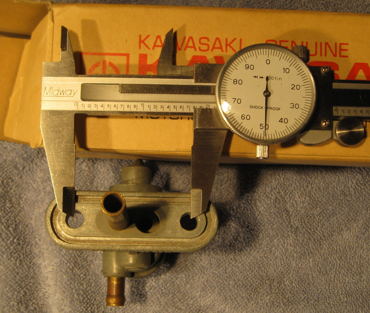

You can get a better measurement by measuring the distance between inside edges of the two holes (using the "outer diameter" hooks), plus the distance between the outside edges (using the "inner diameter" hooks)... divided in half.

SpecialGreen wrote: You can get a better measurement by measuring the distance between inside edges of the two holes (using the "outer diameter" hooks), plus the distance between the outside edges (using the "inner diameter" hooks)... divided in half.
Perhaps, but since the petcock came with 44mm or 34mm spacing one's measurements would need to off by 10mm to get the wrong petcock. That's more than 3/8" difference which is quite a lot. Ed
