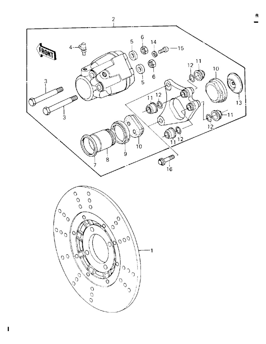

Caliper piston OD: 43 mm (exactly 42,85 - 42,90 mm) / Height: 41 mm

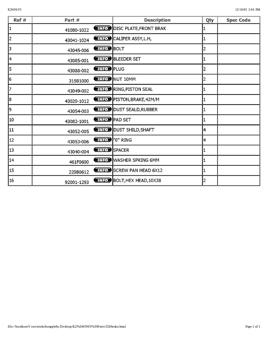

Searching the Kawasaki part number:
Z1Enterprises.com >>> 43020-1012 >>> PM81-3143
. Fits various models & the 650-F1.
I don't know what brand it is. The oem rubber parts may still be available from Kawasaki or Partzilla.
I installed a K&L caliper piston & rebuild kit from Z1Enterprises with no problems, but as indicated by Nessism, apparently sometimes
they may not fit. I've never had a problem with K&L, though, and everything I've replaced appeared identical to the old parts.
K&L parts are made in Japan.

Does any body know what is the part no. for this piston caliper ring?

This metal ring holds OD of the dust seal in place and is press into caliper piston bore resess. I can´t find any part#!
