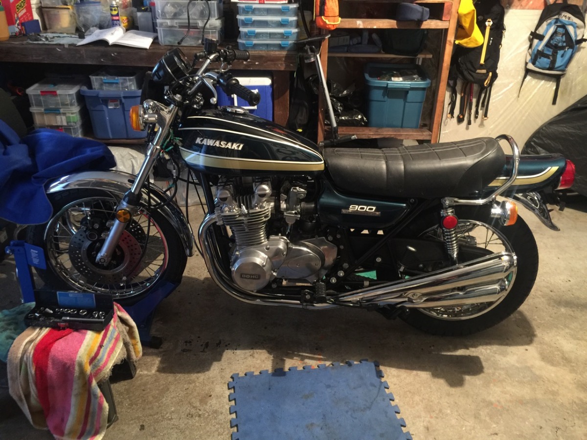

BTW,,,nice bike in your avatar ;;;
Im restoring my buddy 's bike bought,,
sadly after he passed away [which was never for sale ] It was hot roded out in the 80s
1104 big block kit , cams to match , cut trans, 16'' harley rim lowered 1'' , kerker . ect;; in storage 30 years;;;

- Posts: 3121
- Thanks: 1232
Re: 92026-108 Rear Hub Coupling Spacer
17 Jun 2018 19:16
That one is my current daily ride, although I just had a total hip replacement and can't drive for 12 weeks...so it's sitting in the garage. The other one is coming to the end of a total resto. Almost ready to go.
