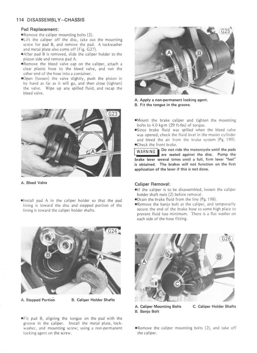

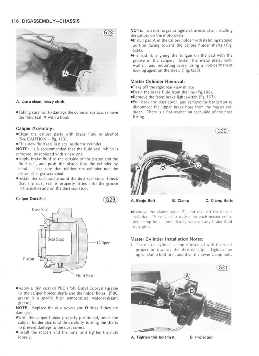

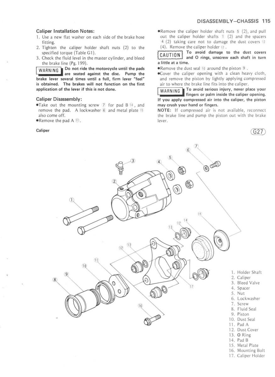

That stuff you are calling grease is, hopefully, some anti-squeal compound.
If you open the Articles tab above, you will see a link to Service Manuals. There you can download a factory manual for the 440. You will find it very helpful.
