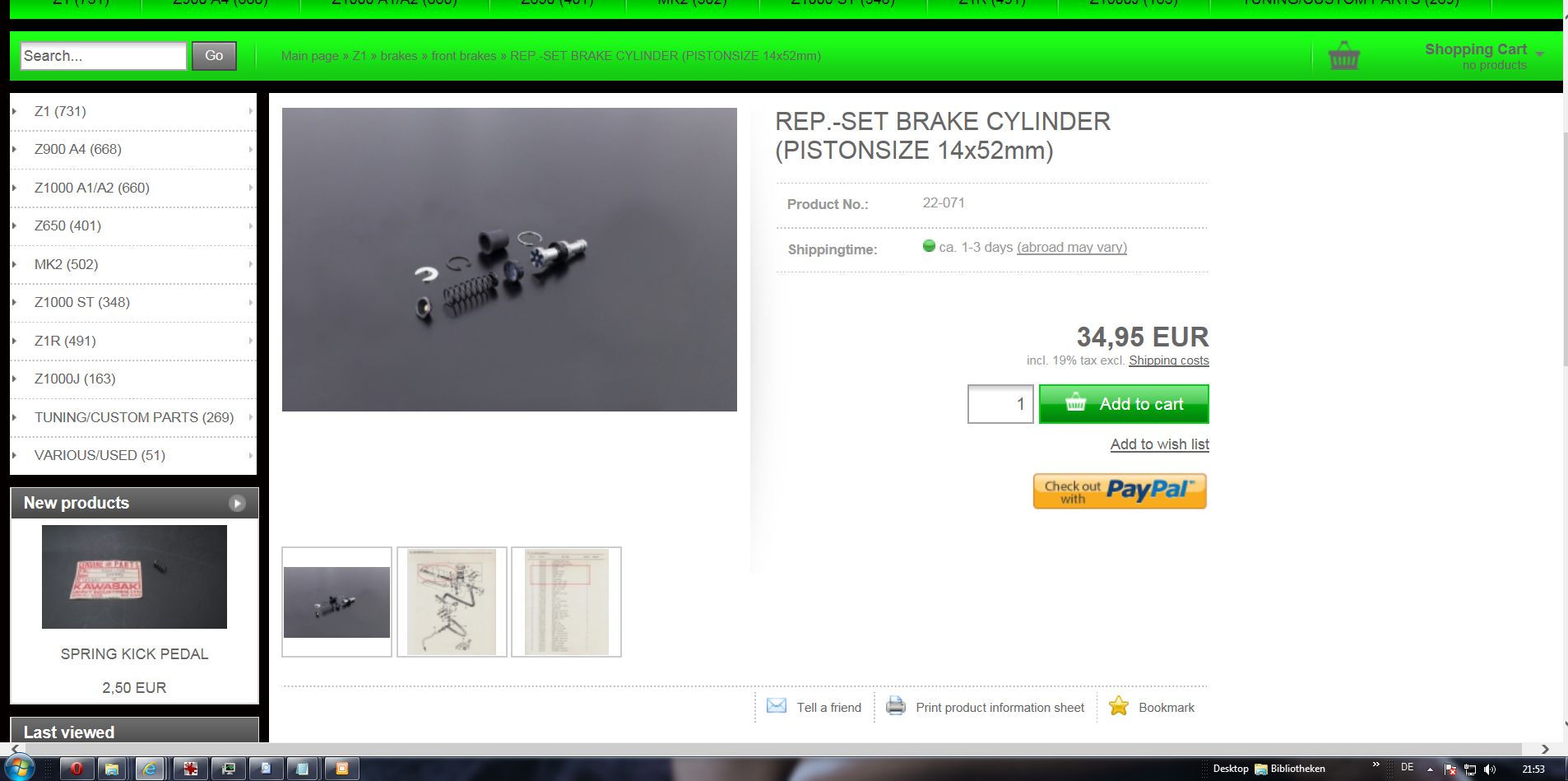

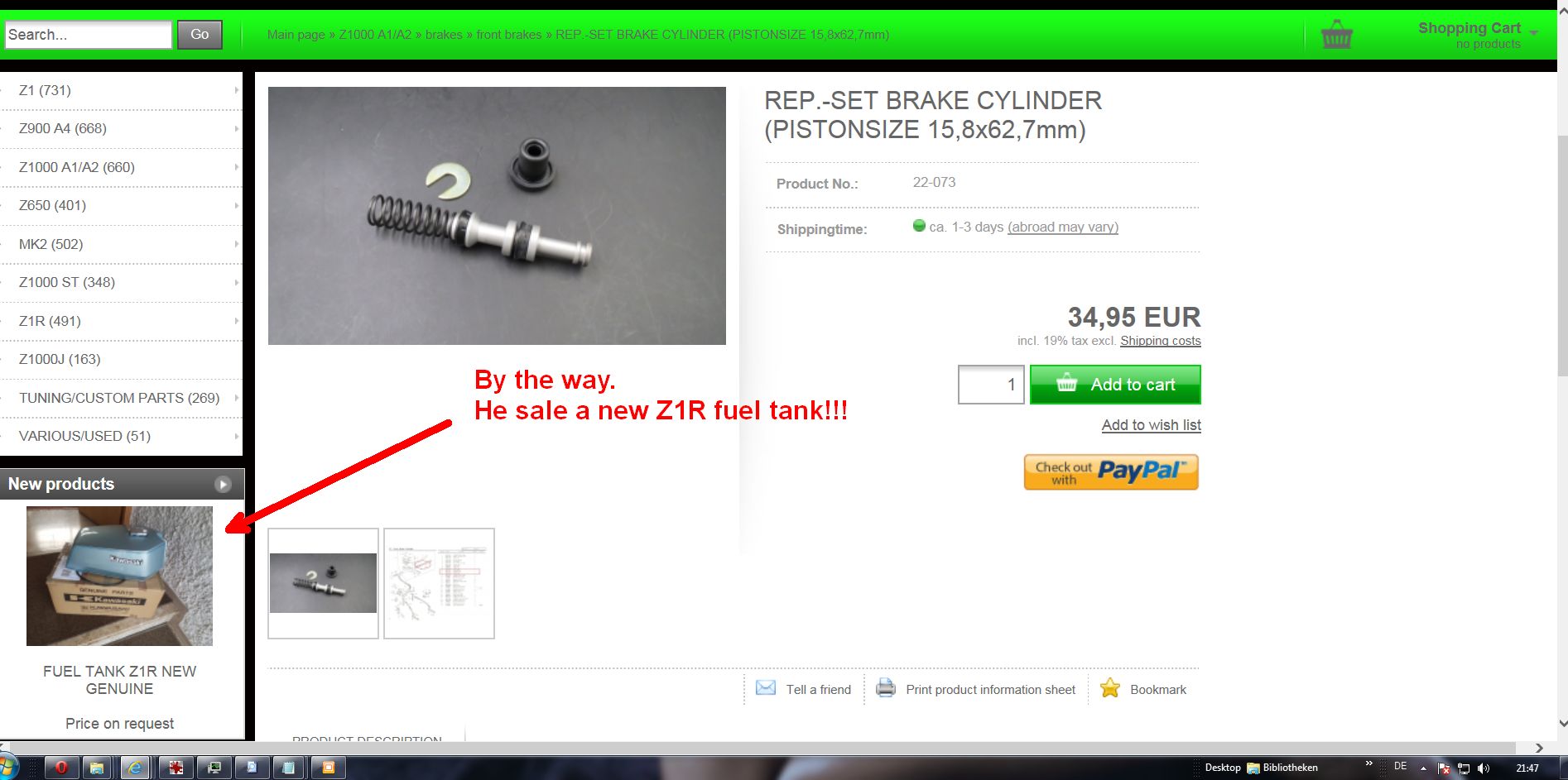

Found something for you.
Single disk
z-fever.de/shop/product_info.php?languag...mass-14x52mm-.html&=
Dual disk
z-fever.de/shop/product_info.php?languag...-15-8x62-7mm-.html&=

Thanks for looking, appreciate your time. Based on the Kawi part numbers referenced in the third pic it looks like it's a piston for early/mid 70's bikes, Z1A commonly.
I did some more detailed searching on the board and have found similar stories on this part but no parts found. I think I'll start looking at kits for same bore MC's and see if I can get a hit. Would be nice to just find the rubber parts.

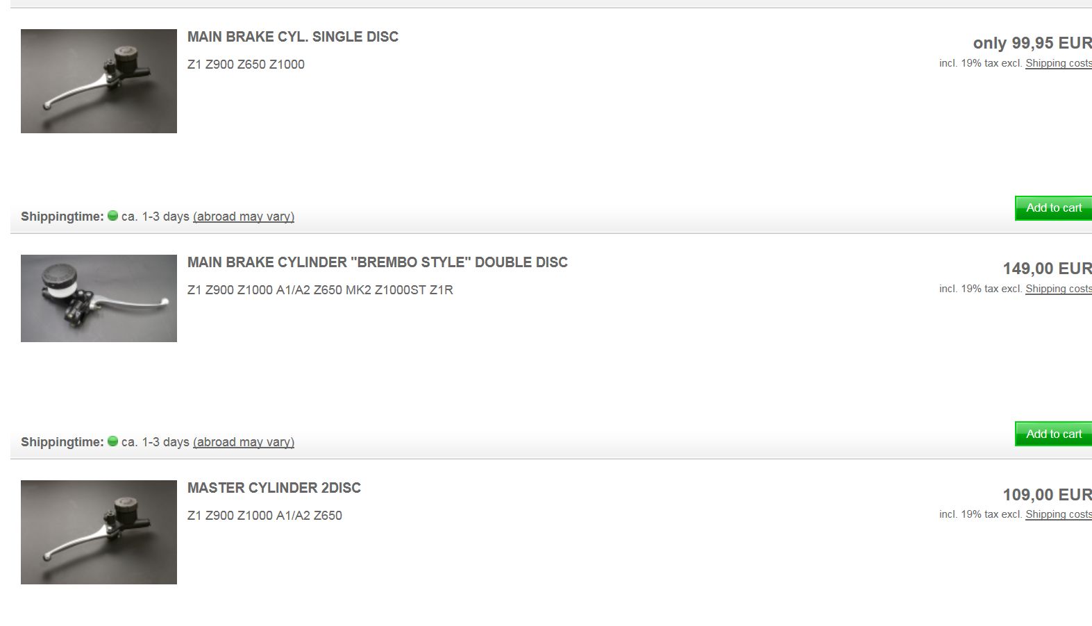

I would buy a new MC, plug, bleeding and have fun.
z-fever.de/shop/index.php?language=en&ca...&cPath=128_179_185&=

@Nessism There is nothing wrong with piston, just the rubber has deformed therefore causing a leak. I'm hoping to find a kit that will work to save this thing. I realize now it will probably be trial and error.
@Scirocco I think I will do just that, get a new compatible MC and ride. Save the original MC for when I get to restoration stage.
