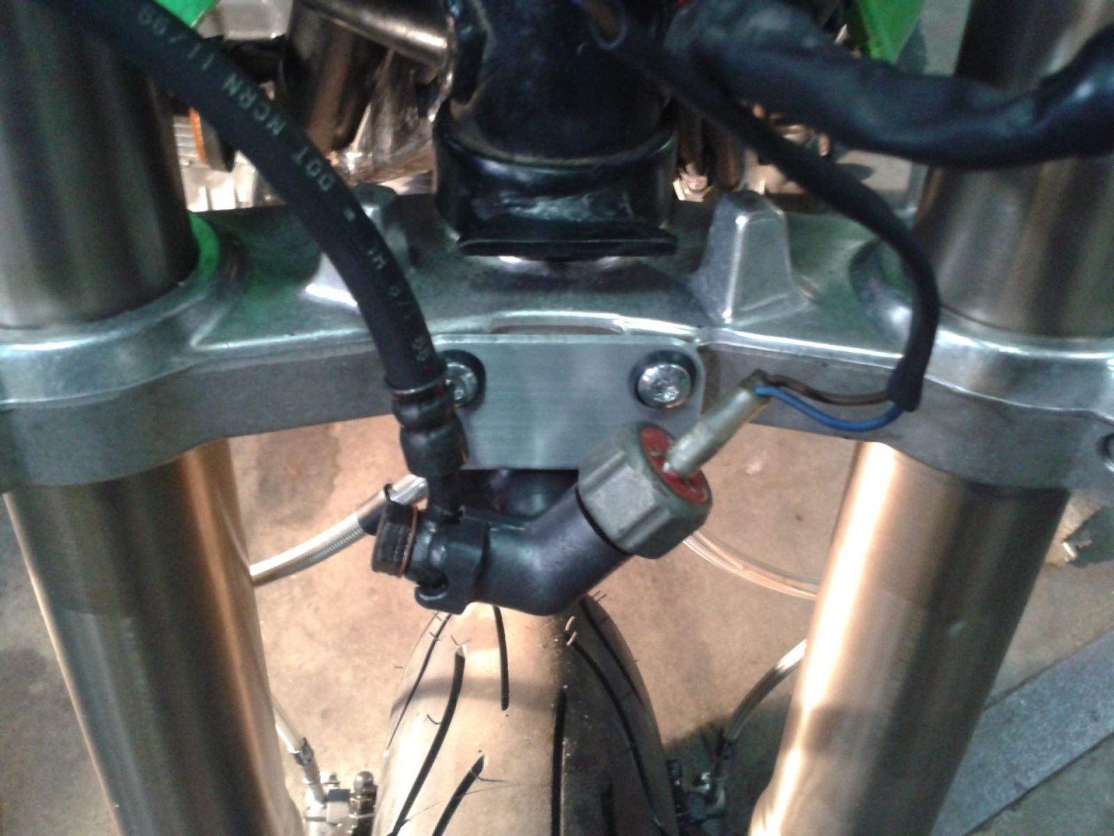

Can the front brake light switch be found at autozone,advance, etc. (1978 Kawasaki 1000 LTD)

No eBay APP ID and/or Cert ID defined in Kunena configurationHis bike has a brake joint with a separate orifice dedicated to a hydraulic brake light switch. He would need to know the thread size to see if an auto parts store has something that will work. The ones I've seen are 1/8" threads & I've seen some that are Made in USA.
..... Just for reference.
