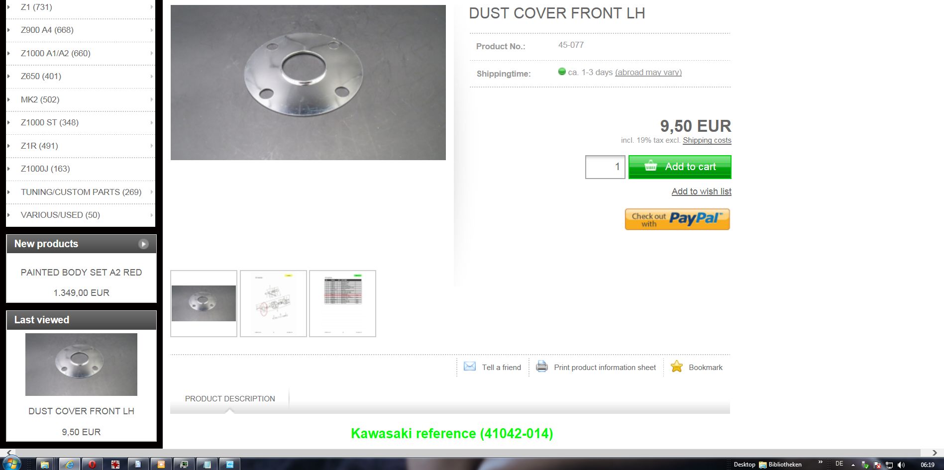

I found one in the UK for $10GP and $7GP shipping at Z-Power.
thank you for your input.
Ron.
