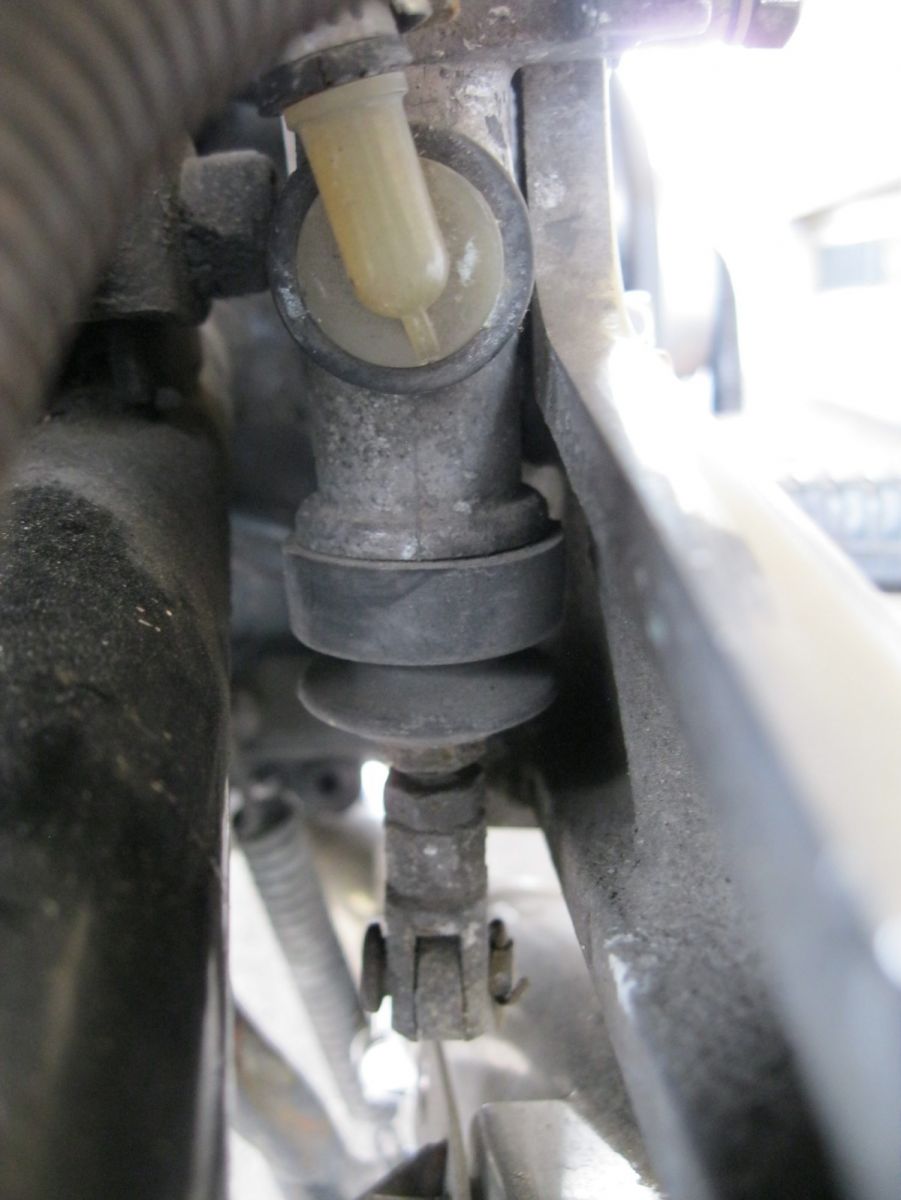

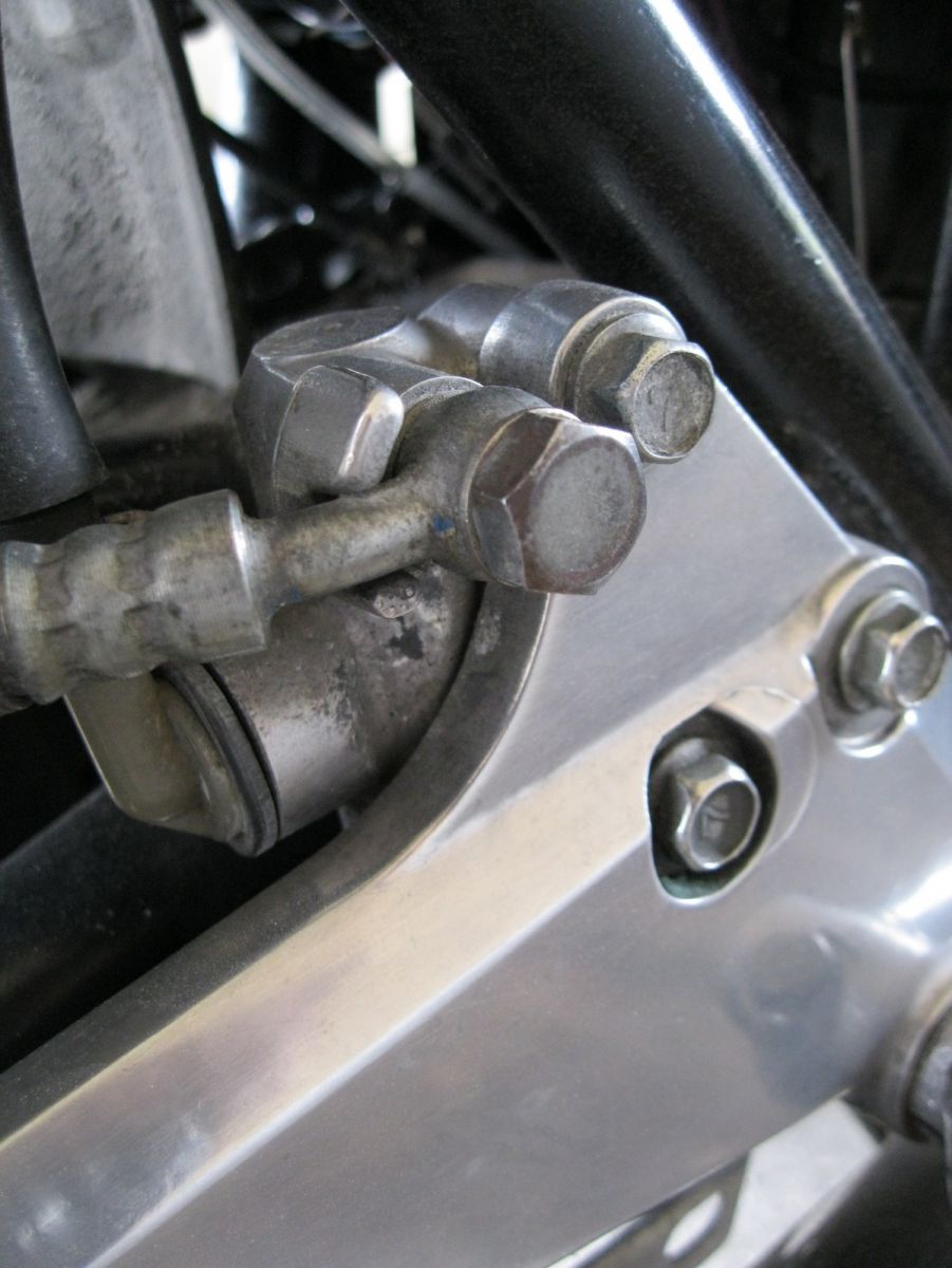

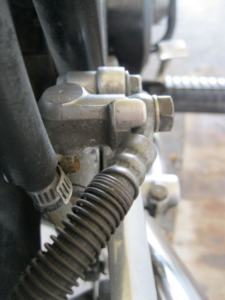

It's almost impossible to get a decent photo with the MC on the bike but until someone comes along with pics of their rebuild this is the best I can get you
Bike is 1980 KZ750E1 and the MC is original as far as I know.
