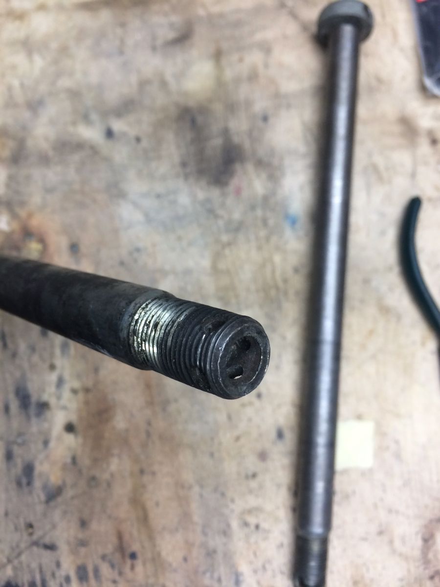

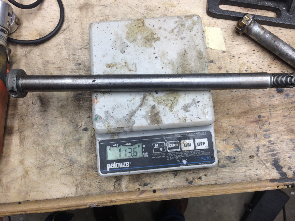

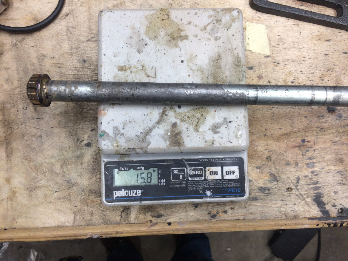

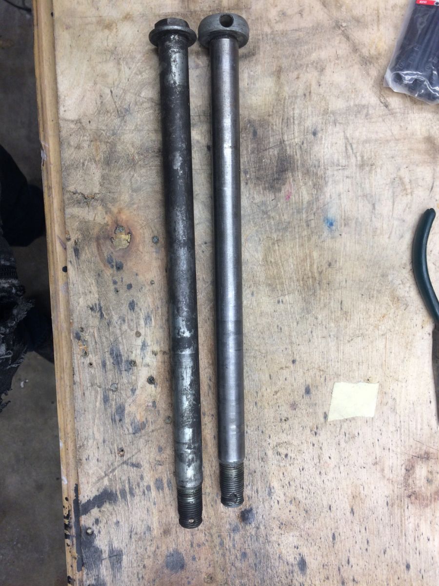

I have this spare 20mm GSXR750 axle Id like to use. Its hollow and weighs half of what my solid ones does. The problem is its too long. The end where the threads are is swagged to 18mm. If i cut this portion off and cut 20mm threads on the main shaft I think the wall thickness will be like 1-2mm thick in the minor thread, so I don't think I can realistically do that. I'm thinking about cutting off the hex head, trimming it to length, and soldering on a new hex. I will pin the hex to the shaft as well for safety's sake. I found this solder which is very low heat (430F/221C) so I believe I should be able to solder the nut on there without removing the temper.
www.harrisproductsgroup.com/en/Products/.../Stay-Brite-Kit.aspx
Is this a bad idea?
Is this a bad idea?
Last edit: 27 Apr 2018 00:00 by DoctoRot.

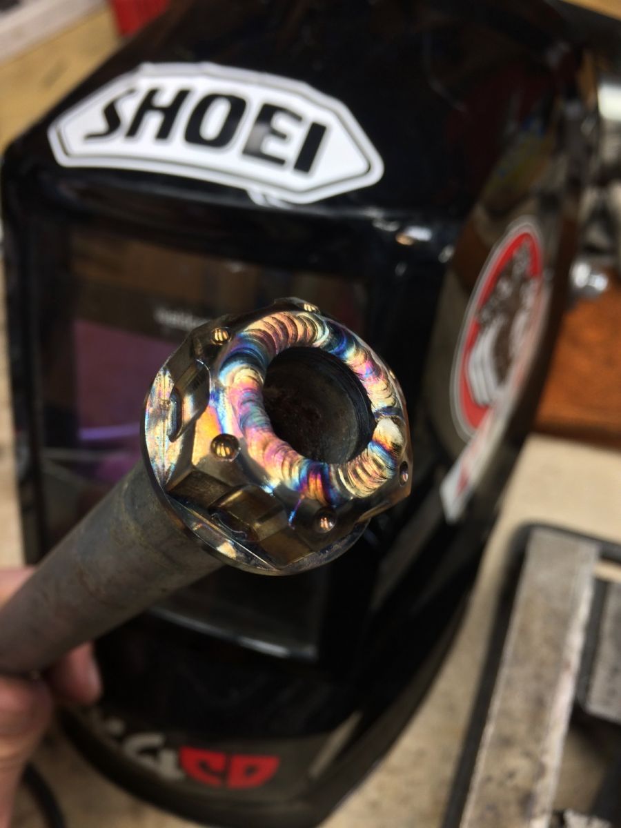

It would look weird with a spacer sticking out. the solid one is already about 1/2" too long so the hollow one is about 1.5" too long. After talking to some people who are way smarter than me, they said welding would be preferable to solder, and that it would be fine as long as I used 309L for the filler as I am going to use a stainless nut. I will feel better about this than the solder.

Yes solder is not for use here...... The trick will be to keep the face of the hex perpendicular to the axle shaft...
Also address the diameter of the hole in the chain adjuster to the diameter of the weld on the hex surface, chamfer the hole to clear the welds, so the contact is against the surface of the hex, so as not to induce stresses in the weld when torquing the axle nut.

Im going to machine a deep chamfer on the nut ID so that the weld sits flush, then I'm going to throw the axle in the lathe to true up the mating surface once it's welded.
