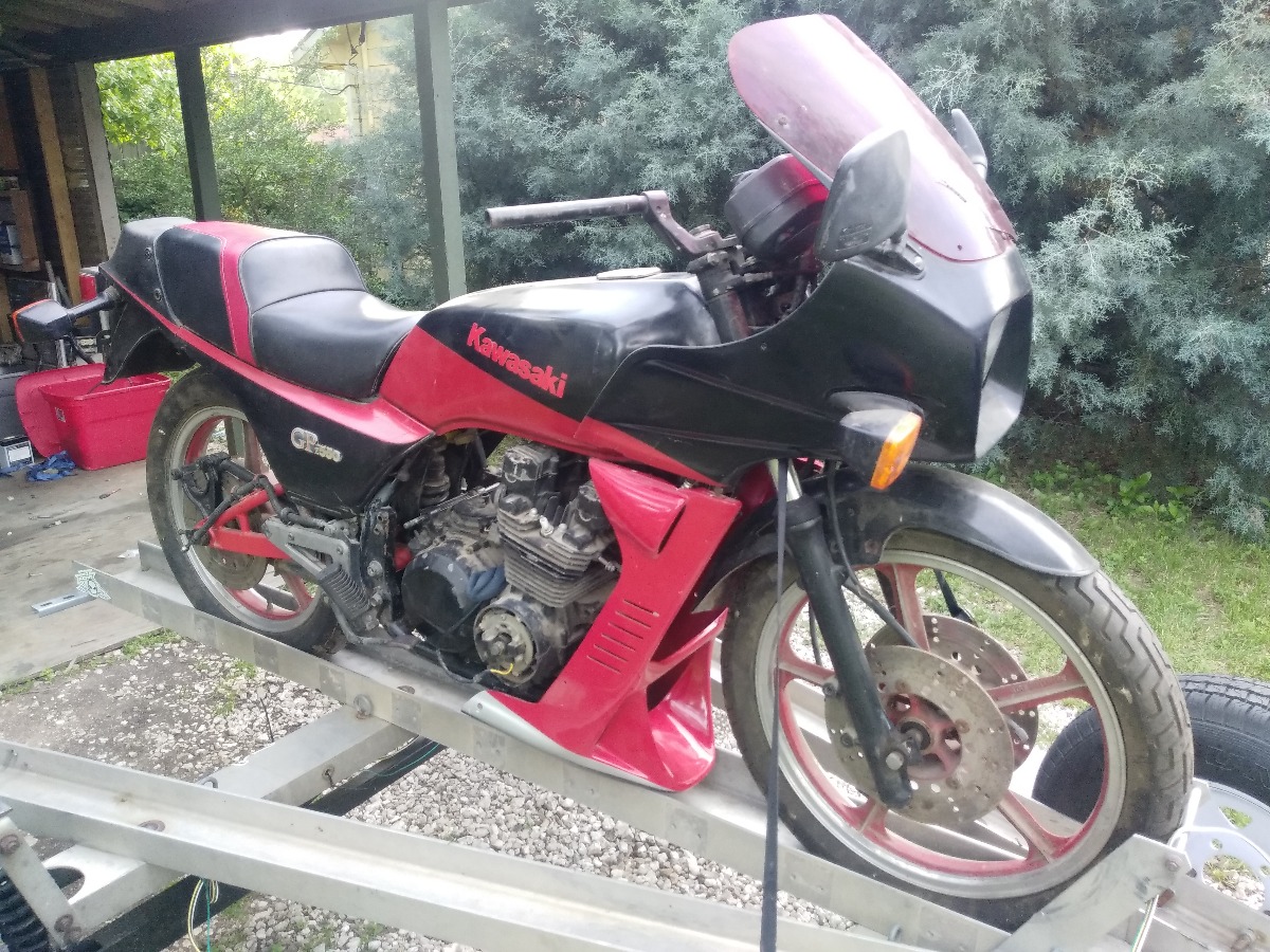

Thinking 83. It has a much larger fairing that the mirrors are mounted to. Has a stem welded to the steer tube to support it. Unitrak rear swingarm. Maybe 84? I've had a couple of 82s and this one is similar in all but the fairing.

Thats an 82 or 83 with a 84 or 85 front fairing . Looks like a 84-85 wheel on the back too . Is that a three spoke on the rear looks small . It should have a 5 spoke like the front .
Front fender from a 84-85 too .
Should have the little fairing like the one in my aviator
I might have a rear wheel for that .

Rear is 5 spoke. Cleaned up what's left of the sticker and it says 82

Front wheel took a hard hit , so that's what started all of this. The one I have out in the shed is completely missing it's front wheel, so I have two rear wheels and an extra drive hub or two.... So, back to looking at front wheels while I try to piece together a complete rack of carbs and see which motor wants to run.
