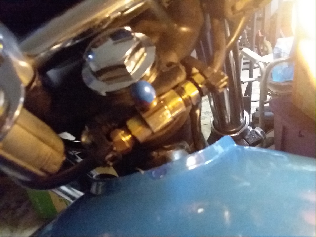

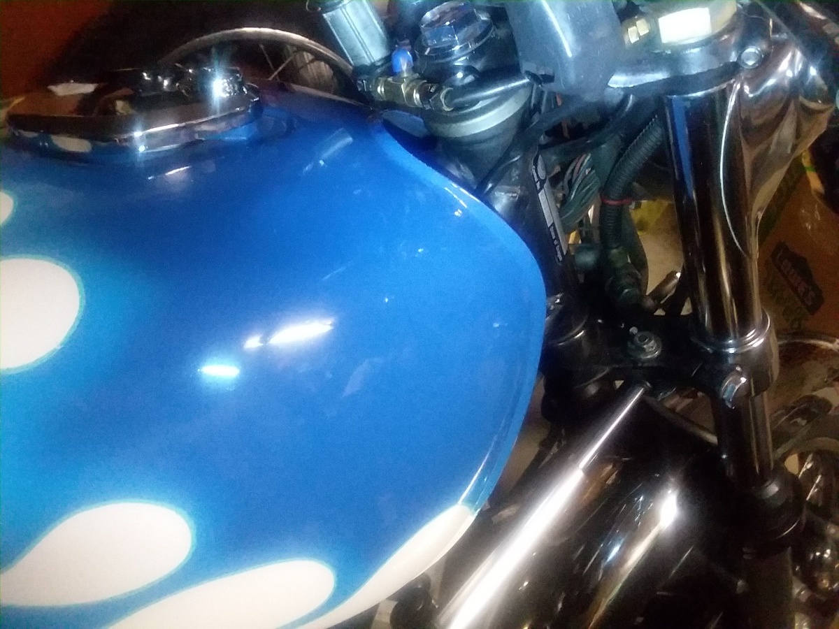

Changing fork oil on kz 900 with goki.. air forks that have equal filling system
- kawie73
- Posts: 2
13 Apr 2018 18:28 - 13 Apr 2018 20:42
I was wondering if it would be possible to change the fork oil without removing the fork bolts and using the the equal filling air forks valve by removing the valve stem and using a syrynge to fill on my kz 900 the lines also disconnect at the fork plug cap so it seems it would also be able to do them individual as well?what weight of fork oil should I use and how much in each leg?
Last edit: 13 Apr 2018 20:42 by kawie73. Reason: More pics
- Thanks: 2260
Re: Changing fork oil on kz 900 with goki.. air forks that have equal filling system
13 Apr 2018 23:09
Without removing the fork bolts you can not drain, clean and wash out the old fork oil.
Don´t be so lazy. I have it done dozens of time on different bikes.
Some forks oil changes have oil volume or oil level high technical guidelines.
- Thanks: 2830
14 Apr 2018 05:23 - 14 Apr 2018 05:24Scirocco wrote: .....
Don´t be so lazy.....
Amen! Ed
