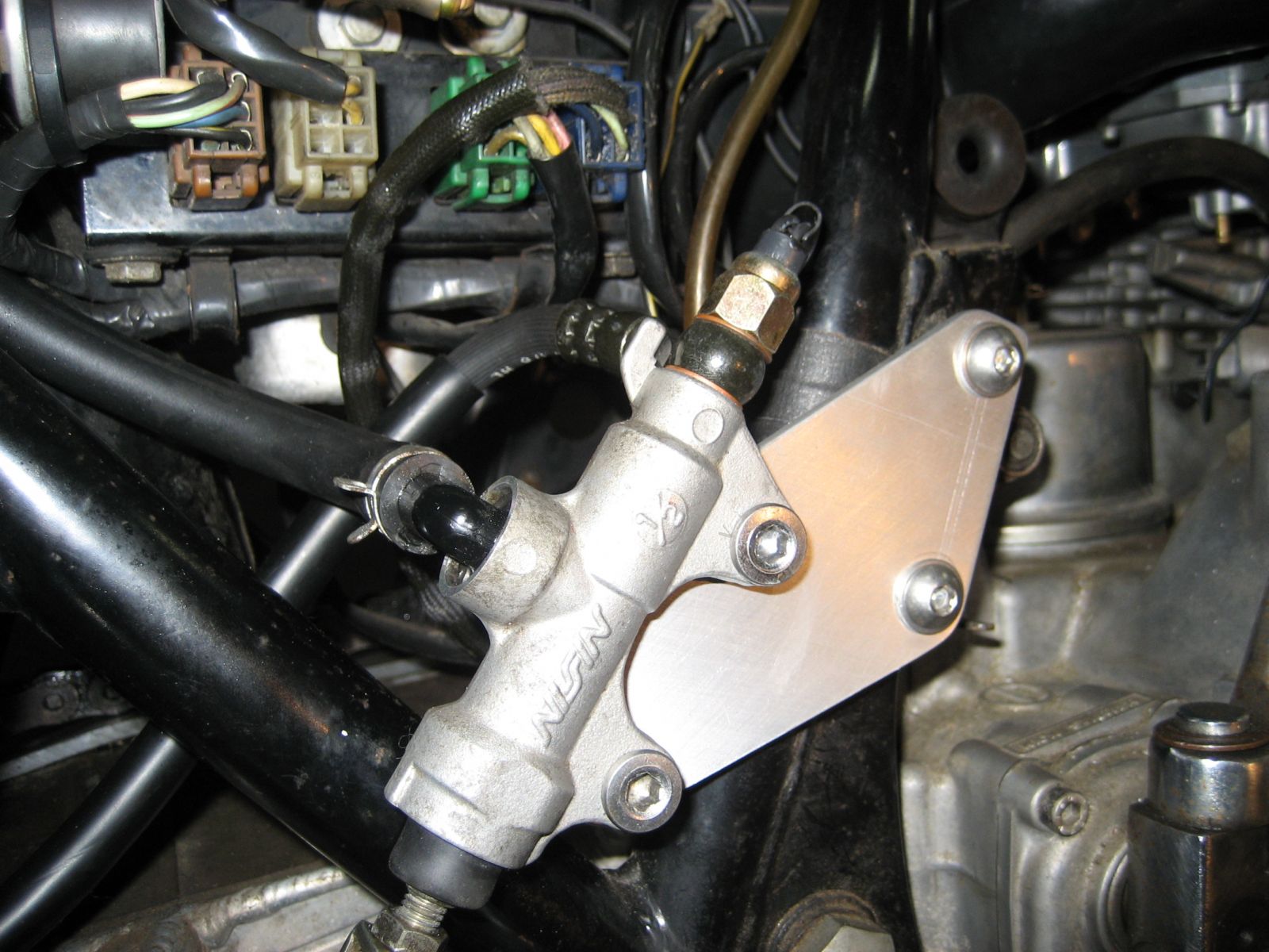

That rear master was a 1-year, 1-model unit.
I don't think I've ever seen a rebuild kit, and the bores out there all seem to be pitted or at least less than shiny.
You can retrofit a Ninja 250 master with a little fabrication.
You can still use the original reservoir. I think the Ninja hose just has to be cut down a bit.
www.kzrider.com/forum/5-chassis/531950-a...l=component&type=raw
