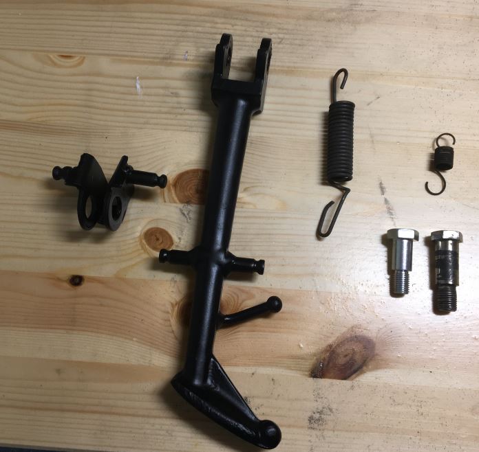

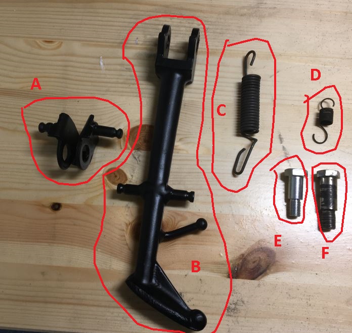

I have problem to find correct bolt for the side stand. My bike is a 650 SR 1981 European model.
I have tried different models on Partzilla, but none is identical to my stand.
I have added to photos below one where I have named the parts.
All the stands I have found on partzilla don`t have part A and D.
I have ordred a bolt E, and I think these is correct to the stands I find on partzilla, but not to mean...
The large spring C have I got it was identical to the other stands...
So I hope somebody here can help me

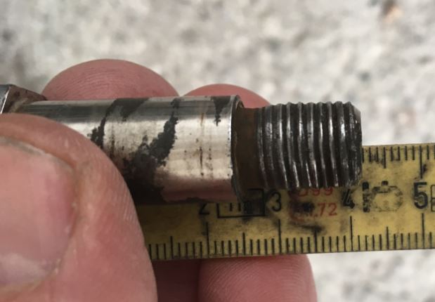

The bolt is approx. 4cm long.
I need:
1. New bolt (part F)
2. New spring (E)
Thank you.

The side stand is set up to use 2 springs - notice there are spring mounts on both side of the stand. I have some info which indicates such a stand was stock on
some of the F2, F3 and F4 models. The part# I have for this type of stand is 34024-1004. The part # for the bolt on that stand is 92001-1011. Maybe doing a search for Kawasaki part# will result in the proper bolt.

Thank you
I think I found it now, cross my fingers
