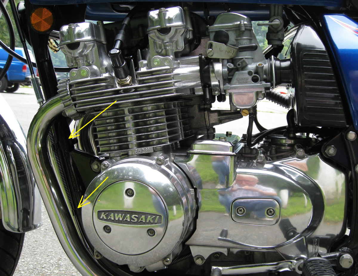

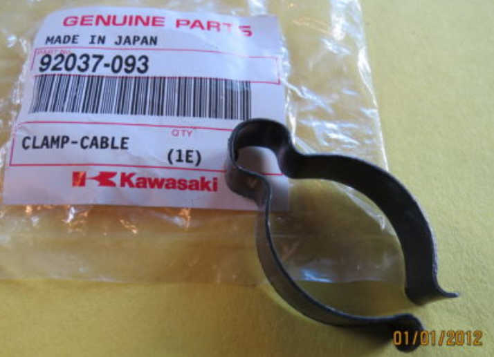

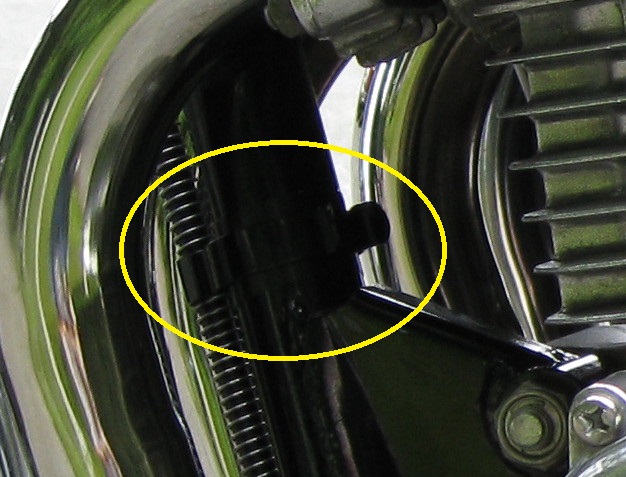

On my 1977 KZ650-C1 the clutch cable came routed on the outside of the frame as shown in the first image below. It is held close to the frame by 2 clamps (see 2nd and 3rd images below). Ed

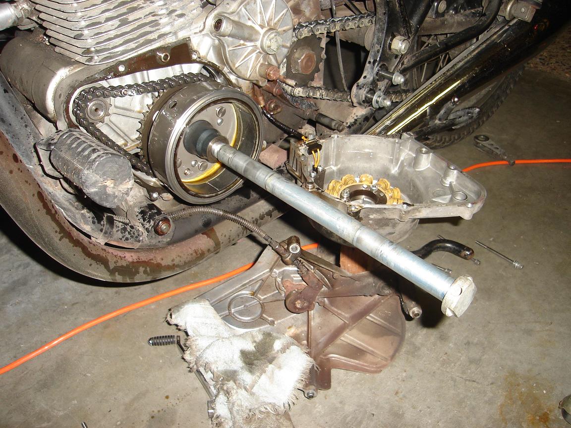

Rainman wrote: Inside frame, under front case mount.
What the heck are you doing Jim?
Kzsolo, I think that with those straight bars you are going to find the stock cable is a little long for standard routing
Looks like Jim is using the rear axle to pull the alternator off the crank. It is a time-honored method.

Jack, yes using the rear axle (note the adjuster on the floor by the rear tire) to remove the flywheel to rebuild the starter clutch. This was back in 2008.
