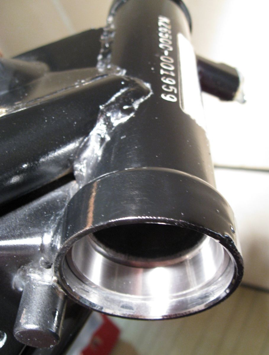

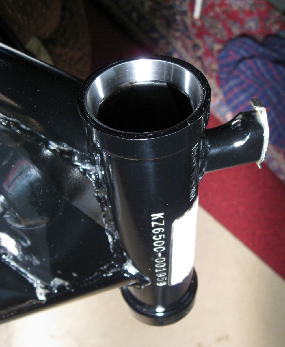

Yes; the old races must be removed. The new races should fit in a way similar to the ones I installed on my KZ650-C1. Ed
